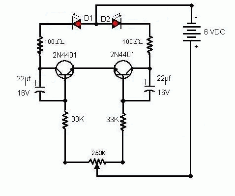

Well, I rewired the circuit making the changes indicated and I still can't get it to oscillate. Removed all LEDs except one for each 'leg' of the circuit and wired each with it's own resistor. Changed the capacitors out to several different values as well as the 33K resistors. As a last resort I also changed out the 2N4401 transistors (just in case I'd fried them - which turned out NOT to be the case since they worked well in another similar circuit I already had built) Also tried reversing the polarity, which didn't work either. There was one other thing that I tried and that's where the emitters of the two transistors are connected together and show going to ground. I am under the impression that the 'ground' in this case is the negative side of the 6 volt power source, but when that connection is made all it does is to completely kill the circuit. With the ground removed and power connected, the individual LEDs will light but not oscillate. The 250K pots only have the effect of varying the amount of brightness from one LED to the other when rotated from one extreme to the other.
As information, I have re-drawn the schematic with the corrections. I would have posted this, but don't know the procedure to do so on this site.

OK, here's the schematic of how it's wired at the present time. It still refuses to oscillate. Note that the corrections/modifications mentioned earlier are included and I have included only [color=#BF0000]ONE[/color] LED on each side. If I can get it to work, I'll go back and add the rest as they were shown on the original schematic.[attachment=0]

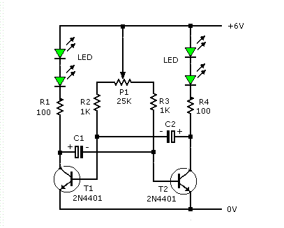

I have redrawn your circuit with the caps connected to the correct points. The circuit is of an astable multivibrator and the collector of each transistor has to be cross-coupled to the other transistor’s base.
My initial quick check of the original circuit did not alert me to a couple of other faults. The original did not show properly the voltage that supplied the LEDs. It looked to me like 10V with the top of the lettering cut off. If it was, then 100ohms is far too low – it would drive the LEDs at about 80mA. The gain of each transistor is about 100, so it would have needed a base resistance for each transistor to give a drive of at least 800microamps to make the circuit work. That would mean a minimum of 7500ohms – not the 33k + 250K shown.
In my circuit I have allowed for 2 LEDs in series in each leg. They drop about 2 volts each leaving about 2volts dropped across the 100ohms. If you want more, wire them in series and add a couple of volts to the supply voltage for each LED added. If you just want one LED, then increase the 100ohms.
The LEDs will take about 20mA, so that means the maximum base resistance will need to be 30K to give a 20mA/100 base drive, so I have picked the values shown.
The values of the caps will need to be upwards of 100uF – depending on the flash rate you require.
That said, a flashing lights circuit using a couple of 555 timers would be far better, and could incorporate random flashing. Let me know if you would like a circuit.
