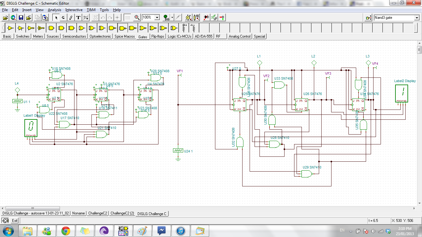

What's wrong with the digital logic design?
Postby adamwth » Wed Jan 23, 2013 6:14 am
Could only upload a picture.
The objective of the design is to make a 3-bit counter that skips counting 4 and 7. So essentially, 0,1,2,3,5,6, repeat.
The one on the left works but the one on the right doesn't. What's wrong with the one on the right?
Thanks in advance.
DIGLG Challenge 3 Pic.png (158.16 KiB) Viewed 4705 times
