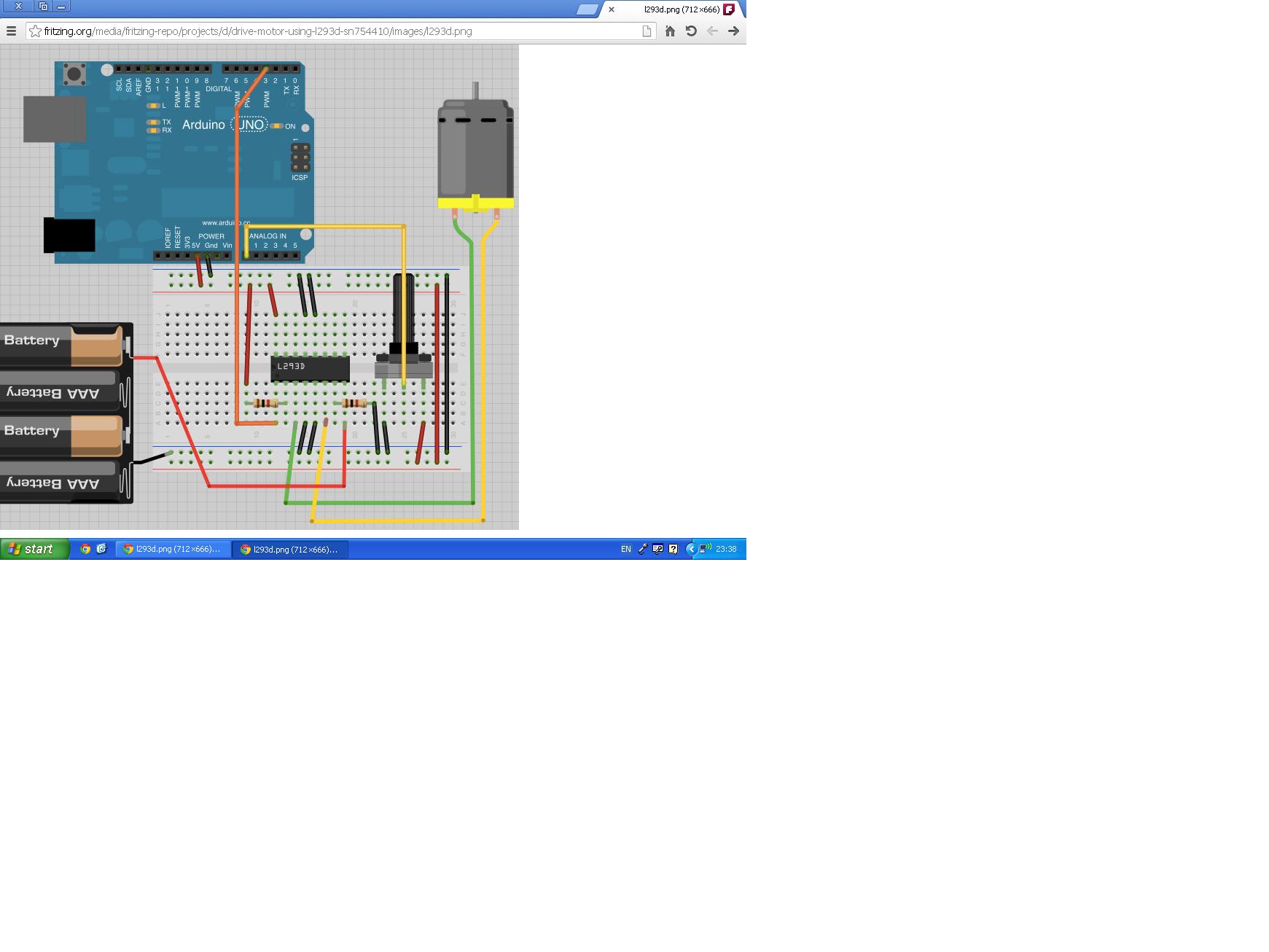

Hello!
I am using the following circuit, with a LiPo 3S 11.1V (which charged, outputs 12.5V), with a split from the bat, one side to a regulator, that converts to 5V towards the Arduino and rest of chip legs, that need 5V and the other split side, stays 12.5V, for the motor that is switched on/off, by the chip via the Arduino, here is the schematics (in case you can't see the link, a picture is attached) :
http://fritzing.org/projects/drive-m...l293d-sn754410
I have 2 questions, regarding this circuit:
1. Why when bat is fully charged (12.5V), still, the motor gets only about 10.5V? Is it the grade of the pot i am using? should i use a higher quality pot? What would happen, if i used instead of that 10k pot a 5k pot? How can i get the full 12.5V?
2. If i want to have this circuit without a pot, just switch the max 12.5V on/off, without changing the voltage, what should i change in the circuit?
Thanks a lot!

Postby pebe » Fri Feb 07, 2014 12:21 pm
You received an answer on another forum that suggested you use a power FET.
That is the best way to go.
