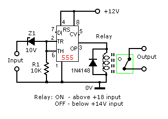

Here is a circuit that should be OK for you that uses a 555 as a bistable. The zener drops the input voltage by 10V.
The relay switches on when pin6 is above 2/3 of the supply volts, and switches off when at pin2 is below 1/3 of the supply volts. If you want to use a different supply to +12V, then change the zener voltage to suit.
555 Voltage Comparitor.GIF (3.41 KiB) Viewed 7761 times

As the circuit is, a 24V supply would need an 8V swing at pins2 & 6. But you only have 8.6V at source (20.3 to 11.7) so the parameters would be a bit tight.
I'll see if I can modify the circuit for you.

It will be more complicated using a 555 because that won't stand a supply voltage of 24V.

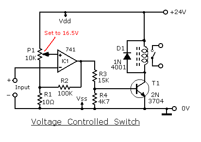

I have drawn a simpler circuit for you. The opamp can be any type - it's not fussy. I have built in a degree of hysteresis so that the relay switches on and off cleanly, but if your input voltage only has two states, 22.3V and 11.7V, then you can leave out R1 and R2 and wire the bottom end of P1 direct to 0V.
The relay switches off when the voltage is higher than 16.5V so take the output from the Common and NO contacts.
OpAmp Voltage Comparitor 2.GIF (4.42 KiB) Viewed 7743 times
