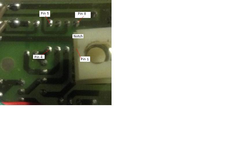

the circuit board
http://images.thesamba.com/vw/gallery/pix/971386.jpg
http://images.thesamba.com/vw/gallery/pix/971385.jpg

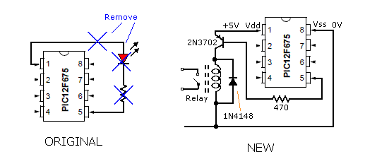

The output pins of the PIC micro are getting near to their maximum current allowed if you drive the reed relay direct. So you need a transistor buffer.
Here is the modified circuit. Remove the LED and its feed resistor. Then add the components shown on the right.
Pin 5 goes low to turn on the LED, so it will now turn on the 2N3702 instead, which will then turn on the relay. The 1N4148 diode stops voltage spikes as the relay turns off.
Components are not fussy – you can use any similar diode and PNP transistor. I cannot find the coil resistance on the Radio Shack site, but have found a similar one elsewhere, so I assume the resistance is about 250ohms. Best of luck.
PIC reed relay.GIF (6.23 KiB) Viewed 15208 times

hi there , wow that's way more complicated that i thought it would be. i am pretty green, but i think i understand what i have to do. i found the 2N3702 transistor and the 1N4148 diode on ebay and i have the reed relay. i think the last thing i would need( is that a 470 ohm resistor in the right bottom corner?) also can you please tell me where the vss 0v post would be on the board? i am mostly a laymen and have never taken an electronics class although i would love to so i can understand this better. i am very good at auto electrical relay circuits and stereo installs but this is way different.

pebe is there any way you could number the posts on the picture of the bottom of the board so i know what is what when i go to do it. thanks that would be so helpful if you could. thanks

Yes, the resistor is 470 ohms.
My circuit showed the PIC with the pin numbers marked on it.
There is a simple rule for identifying pin numbers:- Look for the notch on the top of the IC at one end. Looking at the top, the pin to the left (anticlockwise) from the notch is always Pin1. The other pins are numbered successively from that one, counting in an anticlockwise direction. That rule holds true however many pins the IC has.
I have marked the pins on your photo of the underside.
PIC piins.JPG (22.76 KiB) Viewed 15175 times
