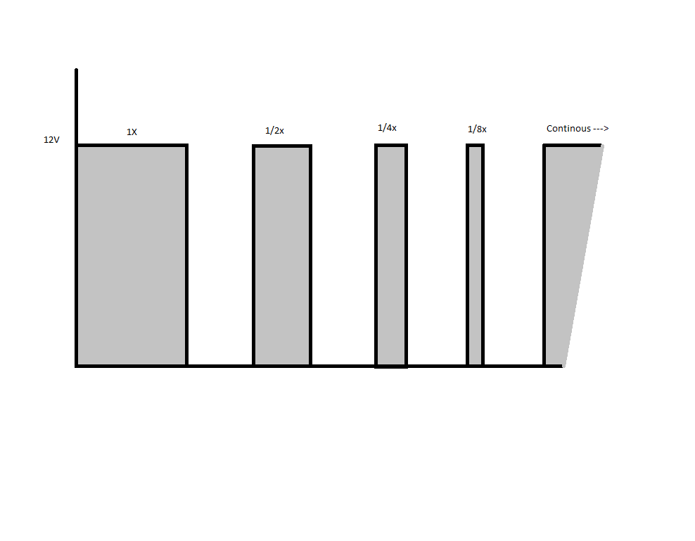

I have built a pulse wave circuit (pulses of equal duration) using a quad nand gate :D . I can set the duration and pulse length and at the moment I have five flashes before the LED output remains on.
I would prefer to have variable pulse widths whose frequency starts slowly and then steadily increases before the LED remains on. e.g. pulllllllse, pulllse, pulse, on ......

I need a circuit to create this output similar to this. The pulse widths do not need to be exact ....

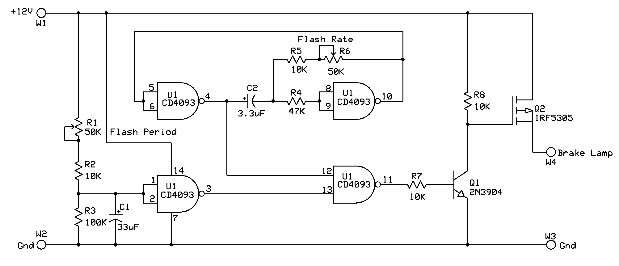

Your original circuit sounds like a circuit I designed and posted on a forum many years ago, for a flashing third brake light. (attached) Now, with the complexity you want, I would just program an 8-pin microcontroller like a PICAXE 08M2.

Thanks. I have already used this exact circuit but trouble is the pulse lengths are equal up to the moment the light turns on permanently.
I would like to change the circuit associated with R1, R2, R3, C1, U1 so the pulses [b]increase in frequency[/b] as per my diagram above.

U1 (Pins 1/2/3) is configured as a monostable multivibrator that puts out "one" pulse with a width set by R1, R2, R3, and C1. Its output NAND'ed with U1(Pins11/12/13) switches the fixed frequency/width pulses from the astable oscillator U1( Pins 4/5/6 and 7/8/9) briefly ON to the Output (Q1 and Q2). I don't see an easy way at the moment to ramp the pulse width of the astable during the time the monostable is high.
