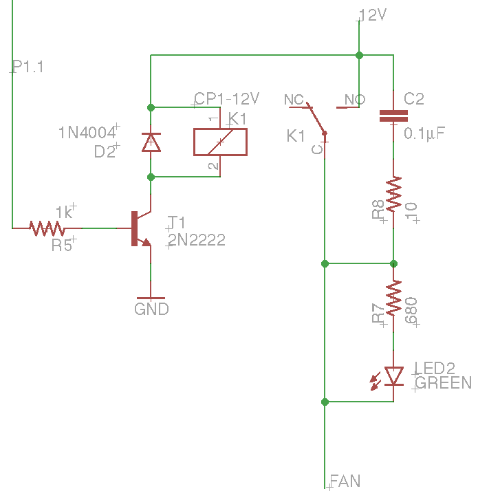

I've read through the data sheet and other articles but the more I read, the more I seem to get that for my simple circuit there are limitless possibilities for cap selection. For example, for C3, a 100µF aluminum cap will suffice though a tantalum is preferred. However, if a tantalum is used, the value may be lowered to 47µF (even lower for other considerations). For C1 and C2, the consensus seems to be aluminum for cost considerations. Would there be any compelling reason to use ceramic for either C1 or C2?

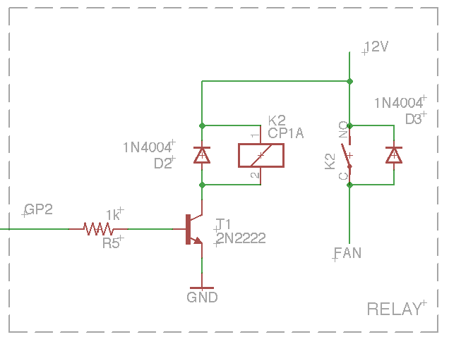

[quote="pebe"]Switching off would then leave the field open-circuit and the energy left in it by its magnetic field would dissipate as an arc at the relay contacts and possibly destroy them. Adding a reverse biased diode across the contacts as a suppressor would prevent that.[/quote]
Added, thanks.

Thank you for your help and patience. After reading more about relays, I wondered if a RC "snubber" across the contacts would be as appropriate as a reverse-biased diode? I also added an LED to the relay output going to the fan. This allows a user to know that if he grounds the thermistor and the green LED is on, there is a fault in the fan wiring or the fan itself.

I don't know whether an RC snubber would be OK, because I always use a diode across the inductive component. In your case that would be the fan - not the switch. Maybe some other member can give guidance.
BTW, you show a short across R7 and LED2.

Postby xenix » Sat Jul 04, 2015 1:09 pm
Oops. Didn't notice the short. Thanks. I have the circuit prototyped on a breadboard but using a TI MSP430 that I have several of. I ordered a few PICs and ATtiny85 as well to experiment with. The code is simple but probably not very elegant. I used a [i]while[/i] statement but want to incorporate an interrupt for the ignition status and a timer rather than my [i]delay()[/i] in a loop.
