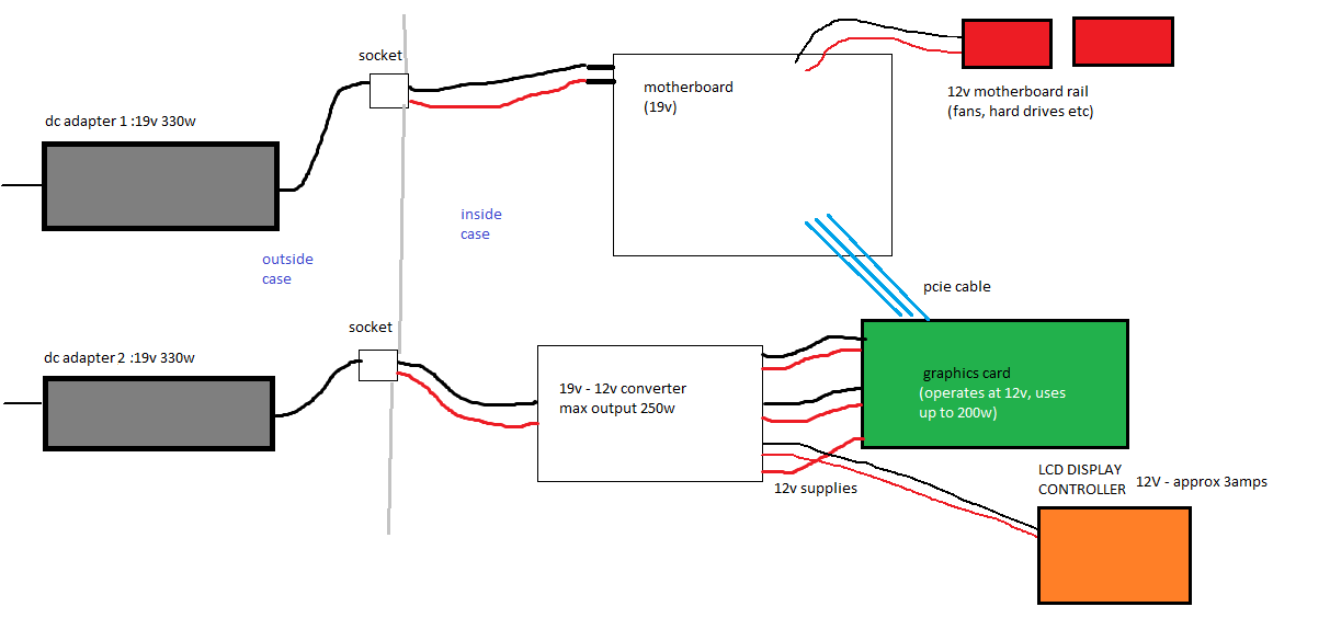

also, the dc adapter is connected through the motherboard via an external jack so there are a couple of 19v wires I can splice into, before the motherboard power connection is made. that's why i was wondering if i could use a resister plus a lower power relay on a seperate circuit to detect the presence of the dc power jack being plugged in.
I can make a diagram if that helps.

Postby jason2012 » Fri Jan 24, 2014 6:46 pm
done in MS paint, apologies :)

Postby pebe » Fri Jan 24, 2014 8:11 pm
Thanks. If you can confirm that the motherboard and the graphics card share a common negative rail, then it can easily be done with a FET.

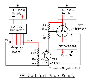

A FET is an electrically controlled switch that can be fitted in series with the main board supply to disconnect it if the supply to the graphics card fails.
Thinking more about it, both boards should share a common negative terminal (ground) so I will draw up a circuit for you.
Re: relay question
Postby pebe » Sun Jan 26, 2014 12:30 pm
Here is the circuit that will disconnect the supply to the motherboard if the supply to the graphics card fails, or is switched off.
The LH side shows the power supply to the graphics card. The RH side shows how the positive lead from the power supply goes to the motherboard via a FET that acts like a switch. The circuit needs a common 0V rail from both supplies – I think that almost certainly the graphics card wiring will provide one.
When operating normally, the 12V supply to the graphics board is fed to the base of TR1 via R3 and turns it on. That gives about 19V across R1 and R2, so the gate of the FET is about 13V negative relative to its source pin. That turns on the FET, which acts like a switch. With a rated maximum current of 31A flowing through it, its resistance would be about 0.06ohms – a negligible value that won’t affect the supply to the board.
If the supply to the graphics card is switched off, TR1 will have no base drive so will go o/c. With no gate voltage, the FET will also switch off and go o/c.
I don’t know what the consumption from the RH power supply is, but you may be able to use a P channel power FET with a lower current rating. TR1 can be almost any small NPN transistor.
Best of luck, and if you need any more info, just come back.

Postby pebe » Mon Jan 27, 2014 10:38 am
The emitter of TR1 should be connected to one of the negative leads coming out of the 19V-12V converter (I have shown it as 0V).
With power switched off, check for continuity between 0V and the negative lead of the right hand 19V 330W power supply, ie. where I have shown the green lead. (Note: you do not need the green lead - it is only in the circuit to show the exiting connection).
It should show very low resistance. If so, they are common and the circuit will work OK
If they are not, will you let me know what the ohms reading is?

Postby jason2012 » Mon Jan 27, 2014 11:08 am
ok, thanks for that clarification, now I have a pretty good idea how to connect everything up, the green wire was confusing me, now I know it just shows a theoretical route to negative on the motherboard power supply.
fortunately , I already have the device for measuring voltages and all that, so I will be able to check the resistance when i'm done.
