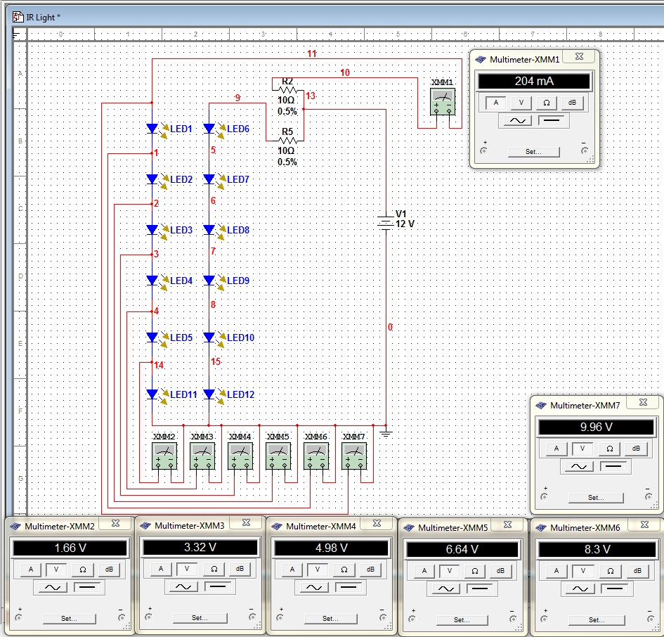

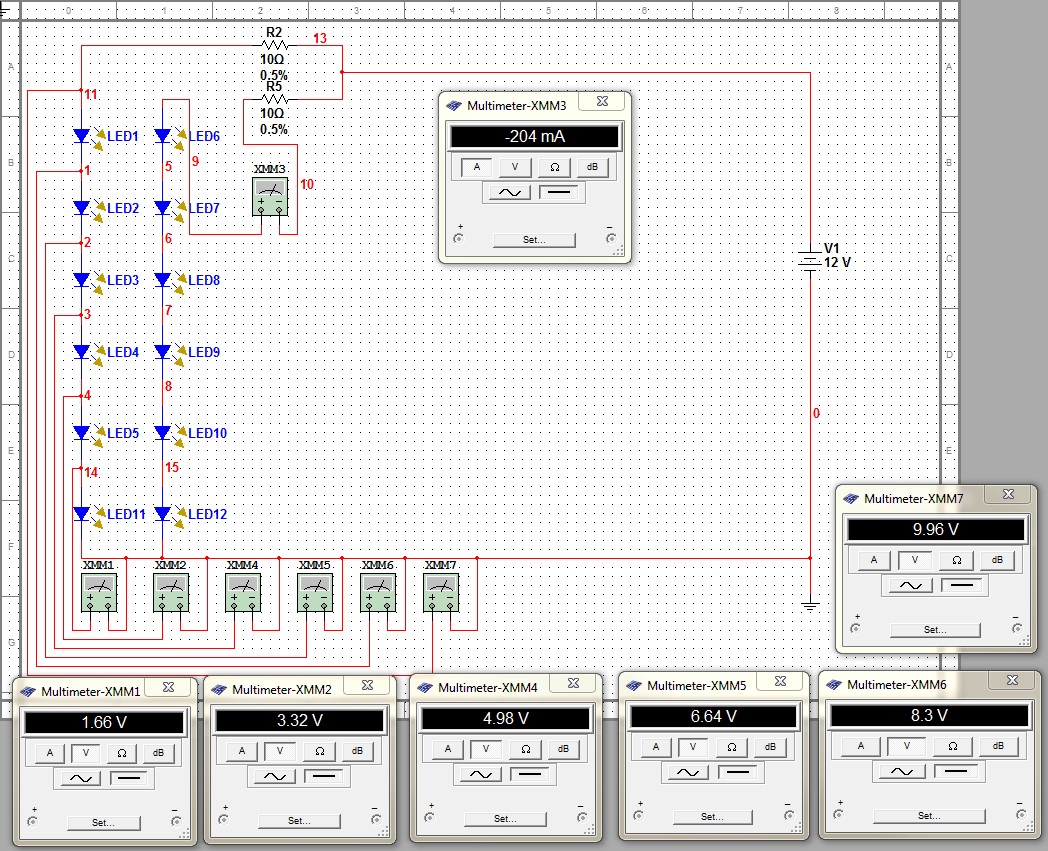

I ran the 12VDC circuit through the simulator. I took measurements on just one of the LED buses.
LED1: 9.96V
LED2: 8.3V
LED3: 6.64V
LED4: 4.98V
LED5: 3.32V
LED11: 1.66V
Current draw: -204ma

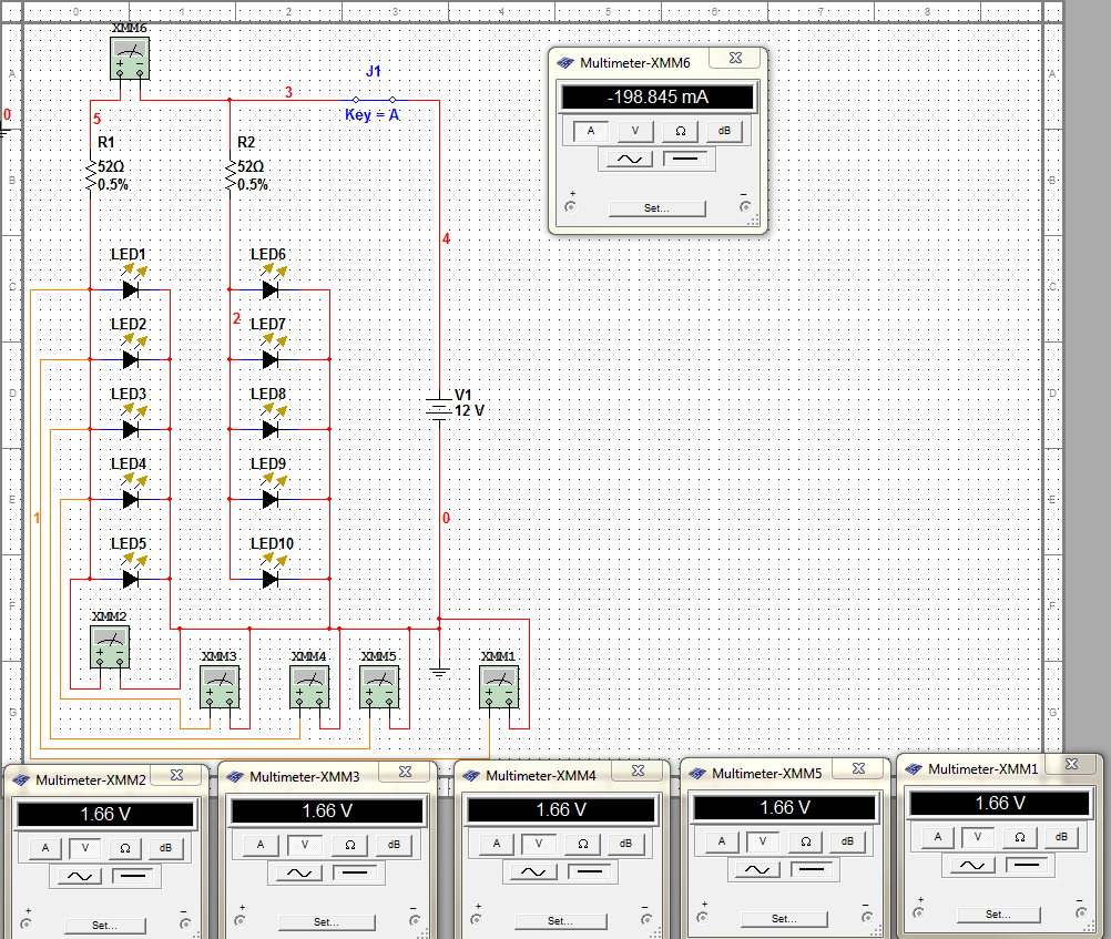

Postby Mavruss » Mon Dec 05, 2011 8:09 pm
I also tinkered with a new design. Instead of series, I went parallel.
The simulator shows a -198.84ma draw and 1.6V on the LEDS. I dumped the 10 ohm resistors for 52 ohm.
12Vparallel LED.png (93.99 KiB) Viewed 22895 times
Mavruss
Posts: 19
Joined: Thu Oct 27, 2011 1:55 pm
Location: WI
Re: Need help designing a basic LED light
Postby admin » Tue Dec 06, 2011 3:17 am
It is important not to connect the LEDs in parallel as it would lead to their ultimate failure. Keep the two branches of series connections and measure voltage across each LED and the voltage across resistor and post it here. I think the LEDs are dropping much more voltage than specified.
regards,
Admin.
Postby Mavruss » Tue Dec 06, 2011 2:59 pm
LED1: 9.96V
LED2: 8.3V
LED3: 6.64V
LED4: 4.98V
LED5: 3.32V
LED6: 1.66V
Power source 12V
Current draw -204ma
this is for only one branch.
If you dont mind me asking, why would running in parallel burn out the LEDs faster?
Mavruss
Posts: 19
Location: WI
Postby admin » Tue Dec 06, 2011 4:45 pm
I meant measure the voltage across LEDs & resistor in the physical circuit which was not working as expected.
When you connect diodes/LEDs in parallel there is a chance of thermal runaway and diodes getting damaged.
regards,
Admin.
admin
Site Admin
Posts: 28
