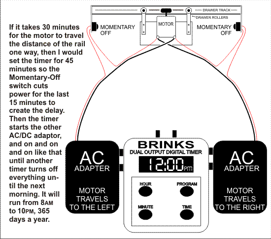

Okay I misunderstood what this circuit did. I thought it would go back and forth over and over, 24/7, until I chose to turn it off.
What I need is for a paludarium (terrarium with half land, half water to simulate a riverbank, with plants, reptiles and fish). Its 6 feet tall, 5 feet wide. Plants need more intense light than flourescents can provide, so I'm using a HID lamp, and instead of having two lamps, one on each side, I'll use a light mover to convey the lamp back and forth on a track, all day long. I would like it to pause around 15 to 30 minutes on each end before going the other way, because the largest plants are on each side and they need to get the most intense light. Everything needs to be automatic. The lamp and mover will be on a timer so they come on at 8 am and go off at 10 pm.
I'm attaching a diagram of the quickest way that I thought would work, but I didn't realize the timer I had with two output plug-ins turn off and on at the same time, not independently of each other. So I figured that I would have to build a circuit from scratch, which brought me to you.
Apologies for the confusion.
Can we modify your circuit to be automatic?
I guess I could use 2 of the Brinks' timers instead, but I was worried they would eventually fall out of sequence with each other. The instructions says they may lose or gain up to 2 minutes a month.

You don't need a jpeg file - they are great for photos but tend to have blurred edges on lines. A GIF file is much smaller, gives cleaner lines, and it can still handle primary colours. But you should have shrunk the drawing first using a photo program or similar, and then saved it as a GIF. For what it's worth, I draw circuits with the 'Paint' program that comes with Windows.
That circuit could be modified but it would need extra chips for timing - probably a 555 and a binary counter - plus extra caps and resistors, but it then starts to get big and messy.
A better way would be to replace all the ICs with a microcontroller. That would handle the motor direction switching and also the time delay between runs. A small 8pin PIC could be programmed to do it. The total component count would then be the PIC plus two switches, two relays, two transistors, two diodes, and a 5V regulator.

Hold off on the programming, but thanks for the offer, it's much appreciated. I'm going to give the Brinks Digital Timers and 2 separate power supplies a try. I mentioned in an earlier post that the dual one I have powers both the plug-ins at the same time, not independently of each other, like I assumed. I'm going to try two single output ones instead.
I used Corel Draw and exported it as a high resolution(500) JPEG. The original was only 3.5 inches by3.5 inches, I guess the high res was the problem. I'm a Graphic Artist, but I'm used to working with vector files(CDR and AI files) for garment screen printing and sign making. We do everything in-house so I rarely send files over the net. I occasionally send artwork proofs as high res JPEGs, but I didn't know that the actual size was effected by the resolution on some sites, or whatever. I'm sending a GIF with my original idea in case you didn't get the original (when I checked back later that day, it didn't show up at all).
