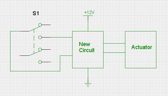

Postby Thomas W » Mon Feb 13, 2012 12:17 pm
Is this a correct block diagram of your system?:
(Without discussing what should actually go into the 'New Circuit' block yet :wink: )
There are probably many ways to do this, but would this be okay?

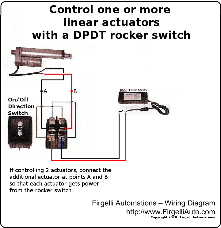

Postby greggreg » Thu Feb 16, 2012 12:00 am
[/attachment]Here's the circuit (not much :D ) without a 'latch' circuit. As can be seen it simply reverses polarity to operate actuator up/down. I'd like to insert a circuît in line with the 'up' connection which latches the power. I'm open to other configurations as long as I still use the dpdt switch I have. In other words, I only want the latching circuit to affect the 'up' operation - down operation should be momentary (only operate with switch manually pushed) for safety reasons. You can also easily see why I want to disable a 'down' button press when the 'up' is latched so I don't short things out.

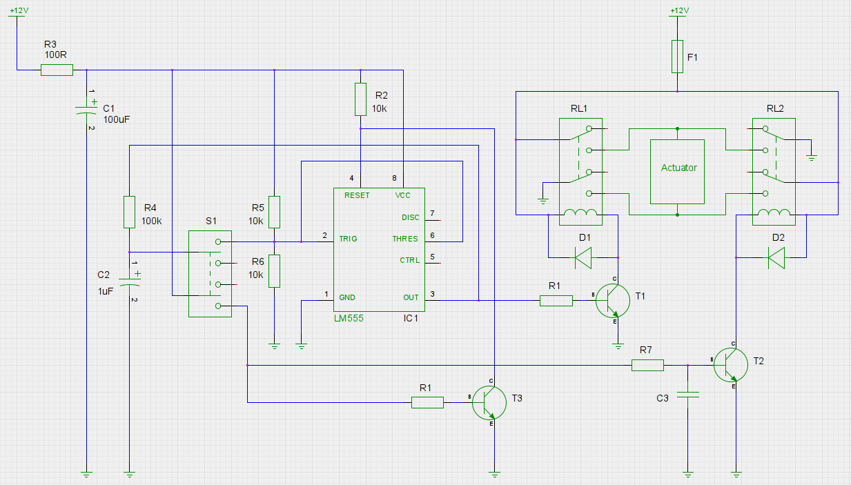

So what you've got already is this circuit:
(I forgot to make it a 'momentary' switch).
I not sure if the new circuit below is 'elegant' but it should work :D :
Your DPDT momentary switch is reused (S1). The polarity reversal of the actuator is inspired by an H-bridge: http://en.wikipedia.org/wiki/H_bridge
The 555 is configured as an electronic toggle switch. Each time the physical momentary switch is pushed 'up' the output of the 555 changes state (ON -> OFF -> ON etc.) T1 and T2 are relay drivers. T3 resets the 555 into OFF state, when S1 is pushed 'down', and RL2 is turned ON, with a little delay due to C3.
D1 and D2 are protecting T1 and T2 from overvoltage when RL1 and RL2 turn off.
F1 is a fuse, just in case the concept won't work, and RL1 and RL2 are turned ON at the same time and short circuits +12 V to 0 V.
R3 and C1 are providing a better supply for the 555, but might not be needed, depending of the quality of the +12 V supply.
R1 (x2 - oops ;-) ) and R7 are limiting the current into T1, T2 and T3.
The 555 toggle switch concept is described here: http://www.bowdenshobbycircuits.info/page9.htm "Relay Toggle Circuit Using a 555 Timer".

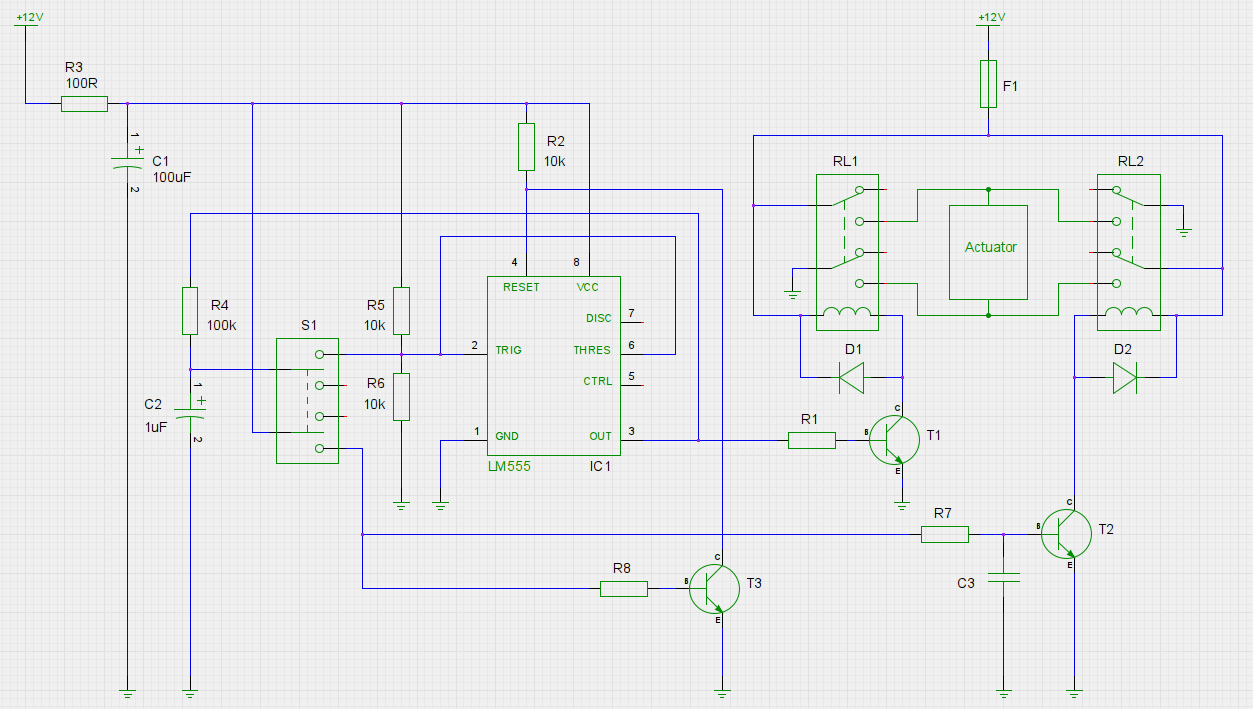

Postby Thomas W » Wed Feb 22, 2012 11:54 am
You're welcome, Greg - looking forward to hearing about your results :)
The size of the transistors T1 and T2 depends on the choice of relay for RL1 and RL2, i.e. how much current do the relays need in order to operate? [mA]
T3 could be a P2N2222 or BC547/BC548.
D2 was flipped by accident in switch_latch_circuit_3.png, so I have updated the schematic (and R1 has been renamed to R8):
