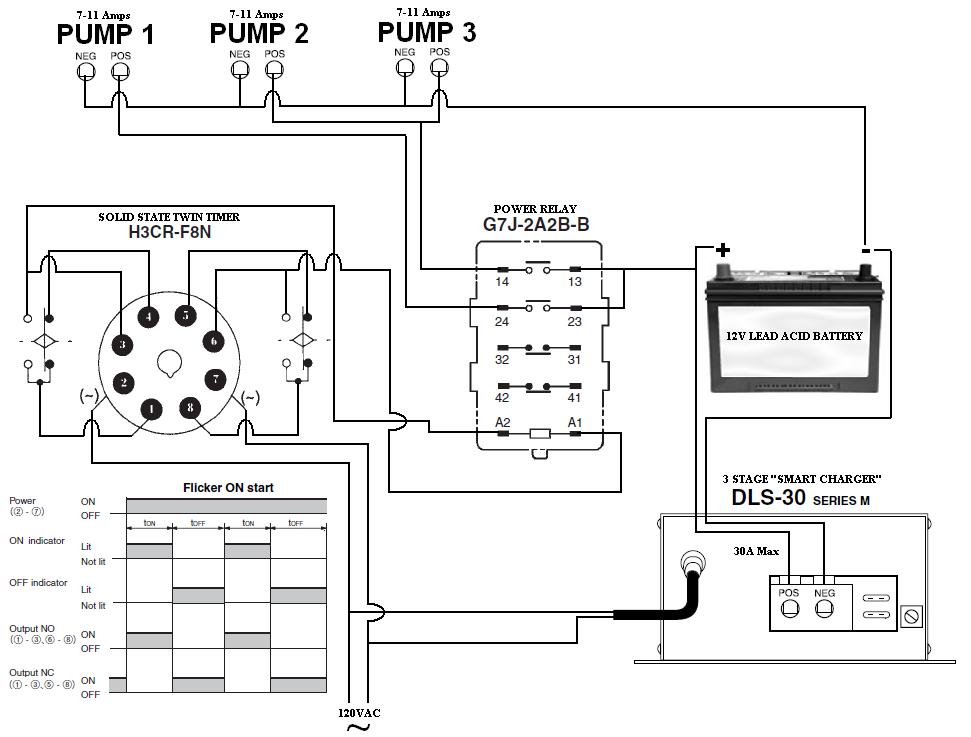

So I have come up with a design. See the attached Schematic & Component Specs.
TWIN TIMER: [url]http://www.ia.omron.com/product/item/h3cr3007r/index.html[/url]
POWER RELAY: [url]http://www.ia.omron.com/product/item/g7j_1020b/index.html[/url]
30A SMART CHARGER: [url]http://www.iotaengineering.com/dls30.htm[/url]
When the timer is powered on (120VAC) it will turn on the Power Relay (120VAC) for 20 minutes (tON). While the Power Relay is on, the Pumps will be on (~12VDC Battery). After 20 minutes the Power Relay will turn off, shutting the pumps off for 60 minutes (tOFF). The cycle will then repeat an infinite number of times. On for 20minutes, Off for 60 minutes (All day, everyday until testing is done). While this is happening the "smart charger" will be charging the 12VDC Battery continuously as needed.
I am concerned with the pump draw of 7-11 amps EACH, 28-33 amps total! What will this do to the battery? Will it effect the battery even though the battery will be continously charging? Is the 60 minutes off cycle enough? Should I only test 12 hours a day and let the battery charge the other 12?
Let me know what you think?
Any other concerns to worry about?
Pump Test Design.JPG (79.34 KiB) Viewed 14748 times
james.e.raymond
Posts: 6
Joined: Thu Oct 25, 2012 6:04 pm
Re: Twin Timer Relay (OMRON) - 12v Battery Fuel Pump
Postby pebe » Sat Nov 03, 2012 12:43 pm
It was not obvious from your initial post that you only wanted to test fuel pumps. If you have not already purchased the various items you specified, then I think you could take a simpler approach.
As you have mains available, then why not power the pumps directly from a 12VDC supply derived from the mains, and forget the battery. If you had a 4-output, ring-of-four counter with an output to 4 terminals and with a 20minute dwell at each count, then you could connect a pump to each output. The counter would then run three (or four) pumps sequentially via switching FETs or relays; with each one being on for 20minutes and off for 60minutes. The maximum continuous power you would then require would be only 12V at 11A. PC ATX power supplies can deliver 15A and are quite cheap to purchase.
Would that be a better approach?
