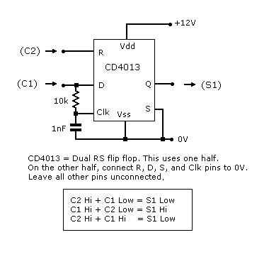

This uses one half of a CD4013 dual RS flip flop.
I hope you find it useful.

In both your simulations you have made the wrong connection from C1. You have it connected to the 'S' (Set) input instead of the 'D' (data) input. The 'S' input should be grounded.
Basically, this is how it should work. A high on C1 takes 'D' high. A few nanoseconds later 'Clk' (Clock) goes high and copies the state of 'D' on to 'Q' so that goes high. The reason for the RC network is to ensure that 'D' has gone high before the clock pin activates.
You wanted C2 to override C1 so a high on C2 operates 'R' (Reset) and takes 'Q' low. According to the truth table in the data sheet, that action takes precedence over anything that happens with the 'D' and 'Clk' pins.
I didn't try the circuit out, so I hope it works OK for you.

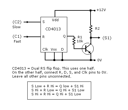

Here is an alternative circuit that is not frequency dependent.
R2 is the collector pullup resistor.

I see you're driving S1 with a transistor. Is a typical SR output insufficient?
Is it ok to use any common SR with your circuit?

Postby pebe » Wed Nov 14, 2012 5:53 am
I had to put the transistor there to invert the output (see the truth table on the circuit). I could not use the -Q (Bar Q) output because both outputs go high when R ans S are both high.
I think you could use any RS flip flop. But if you use the 74*** series, you would need to reduce the supply voltage to 5V.

[quote="johnyradio"]Beautiful. Didn't need the transistor for some reason. Thoughts?[/quote]
That was an inverter to get the output signal to the polarity you asked for in your original posting, ie.
C2 (slow) = S1 low, and
C1 (fast) = S1 High
[quote]Also, needed to convert the slow clock to a pulse (using RC + buffer). Did not give the desired result otherwise. Thoughts?[/quote]
Between pulses, the output takes up the last high state of R or S. So if you want S2 to win when C1 and C2 start together, Then make sure the pulse of S2 is longer.
