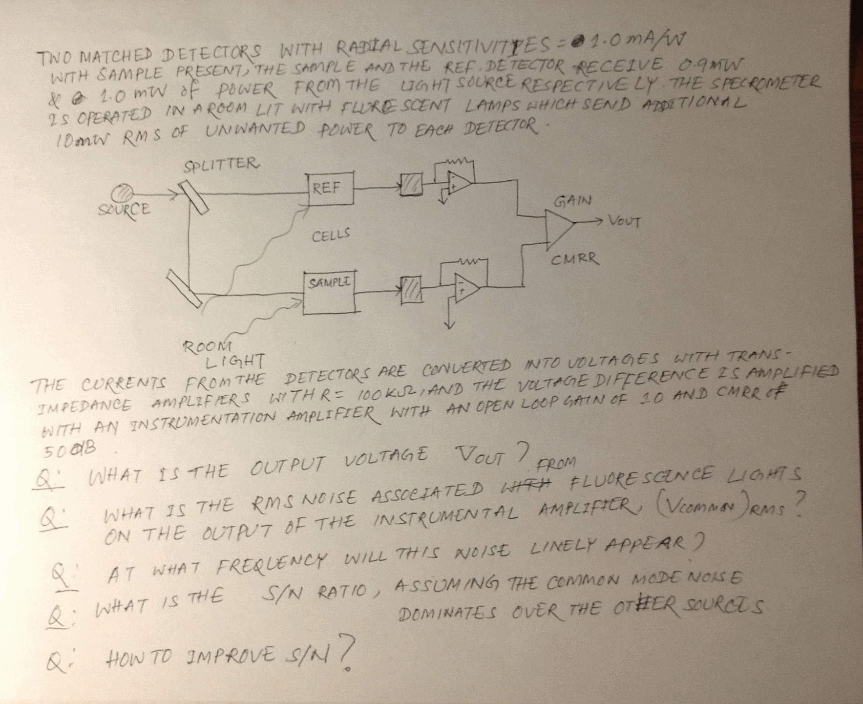

Hi Guys,
need help with the following instrumental amplifier circuit , please see the attachment. Any help is appreciated.
