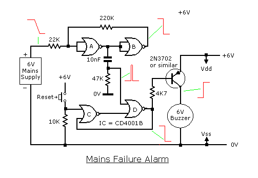

Hi jdp,
Here is the circuit as promised. It is derived from your circuit but only uses one CD4001.
A and B form a Schmitt trigger that gives a sharp pulse into D as the supply voltage falls. C and D form a bistable that is triggered to turn the buzzer on and off. I have fed it from 6V because of the 7V top limit on the buzzer.
Normally, when the mains is on, the battery drain is negligible.
Mains failure alarm.GIF (5.34 KiB) Viewed 18979 times

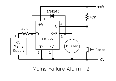

Following up I_Daniel's idea of using a 555 timer, this is probably about the simplest possible circuit .
Mains failure alarm. 2.GIF (3.63 KiB) Viewed 18979 times
