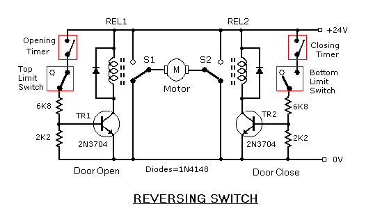

Here is the circuit – about as simple as it gets.
The motor direction is controlled by two SPDT relays REL1 and REL2, with contacts S1 and S2. When REL1 is energised, it puts +24V on the LH side of the motor to open the door. When REL2 is energised, +24V is put on the RH side of the motor to close the door.
The limit switches are wired using the ‘Common’ and ‘Normally Closed’ contacts, so that at the end of the door movement, the switch operates and breaks the contact. The drawing shows their positions when the door is closed and the bottom limit switch has gone open circuit.
Operation is simple. The ‘Open’ timer will put forward bias on to the base of TR1, REL1 will operate and the door will start to open. When the door operates the top limit switch, TR1 will switch off and REL1 will de-energise. The 'Close’ timer will operate TR2 and REL2 in a similar way.
If the motor is trying to close the door instead of opening it, just change over the motor connections.
555 Motor reverse 4.GIF (6.17 KiB) Viewed 24995 times

Thanks. It looks pretty straight forward. I am assuming 6K8 and 2K3 are the diodes. It looks like the relays are 4 pin?? You have to forgive me. Im 72 and the majority of my basic electronics involved vaccuum tubes, risitors - condensors, etc. The first experience was building a cat's whisker radio right after WWI.I.

Th 6K8 and 2K2 are 1/4W resistors. The diodes are the two devices across the relay coils; with their cathodes to the tops of the coils.
In case you are not sure, the three terminals on TR1 and TR2 shown in the circuit are (from the top) C, B and E.
The relays are SPDT types, ie. each has a common connection that can switch between two other contacts - the normally closed one will be marked 'NC' and the other will be normally open and marked 'NO'. Each relay will each have 2pins for the coil and 3pins for the contacts, but there may be 4pins for the contacts - ie. the 'Common' connection may be duplicated.

I finally received the correct relays and all the other parts. They originally shipped DPDT. They are 8 pin SPDT. NTE R14-5A1515-24 24VAC #R95-121.
I am not sure what you mean to orient the diodes "with their cathodes to the tops of the coils." They are smaller than a grain of rice. Also, when speaking of TR1 and TR 2, is C,B and E - Collector, Base and Emitter?

The diodes must be connected so that correct polarity is observed. There will be a ring painted around one end of the body near the lead-out wire, and that wire is its cathode.
Yes, C, B, and E stand for Collector, Base and Emitter .
