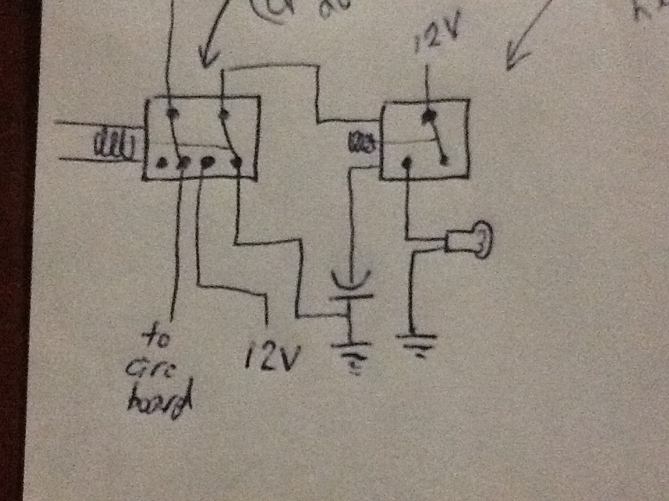

Postby Billybaxter » Fri Jul 19, 2013 9:55 pm
For anyone still following this quiet thread, I investigated the solution kindly offered by one reader (thank you), and although it works, the problem I was faced with was the continuous current drain of the 555 when in the off position, which it would be in most of the time. My solar powered resource is not sufficient to support that.
I did eventually come up with a solution using a second conventional relay. I have attached a rough sketch of it for anyone who's interested. Essentially, in the off position the relays draw no current. When the main double-poled relay is switched, the secondary relay switches on for 1-2 seconds until the capacitor charges up, then the relay switches off again, thus drawing no further current. When the main relay is switched off, the capacitor discharges through the secondary relay. The capacitor setup I found to work best after a bit of trial and error was 3 x 1000microF in parallel.
I hope this intrigues someone if nothing else :)
