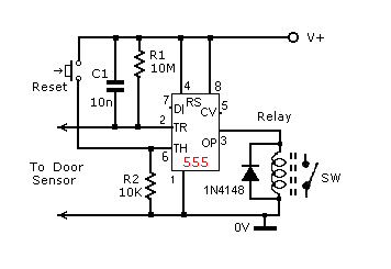

As you are not using a timed period, then you could simplify the circuit by using the 555 as a switch instead of a timer. I have attached a suitable circuit that uses a standard push-button. It doesn't need a transistor to drive the relay - the 555 can provide 200mA current which is plenty for a relay.
Use a supply suitable for the relay coil you are going to use. Pin 2 is held high by R1. Pin 6 is held low by R2 (it can be any value between 470ohms and 100K). Under these circumstances nothing will happen to Pin3. But if you pull Pin2 low (grounding the door sensor) Pin3 will go high and energise the relay. Pressing the reset button will take Pin6 high, and Pin3 will go low and the relay will de-energise. C1 is to prevent Pin2 being triggered by mains hum picked up on the cable if the unit is some way away from the door - you may need it even if you construct the original circuit.

hi agian, this has cleared things up for me a fair bit now, and cheers for this other schematic, it sounds more appropriate for my needs, I am only short of the diode but have ordered some so I can build and test it out on the breadboard. im very keen to begin work using and learning about relays.
incidentally I have already constructed the original circuit substituting the Relay with a piezo to work in the same way but as a type alarm which sounds for a couple of seconds when touched, I ran into trouble with this after copying the schematic perfect, it would not trigger by touching the sensor from pin 2 alone, I found that the only way I could get it to work how the schematic shows was to add a ground wire from the negative rail and attach it to a screw in a light or plug wall plate, or obviously if I touched the touch plate with one hand whiles holding the ground wire with the other. This made some sense I suppose as I have seen other touch plate schematics using 2 leads as the sensors, I was just confused how the schematic I was following did not mention this.
I notice in the new schematic u posted it has 2 arrows going to door, Im assuming the one from the negative rail is again to be earthed???

Hi H_J. Yes, connect the 0V line to earth.
If the timed circuit you built is OK without a cap across the 10M, then if the circuit I gave you doesn't trigger, leave out C1.

just to let you know I have been testing the Schematic you posted and am very impressed with it. However now that i have tested this door flap camera trigger system, i have bumped into a few problems such as the letter flap being non conductive, and having to use the 2 touch wires soldered to 2 thin strips of adhesive copper tape in line along the inner bottom of the letter flap, where fingers will touch both when lifting the flap, it does work but has its problems.
Im rather interested if this relay circuit can work in another way replacing the touch plates with just a switch, or just basically limiting the circuit to activate the relay when the 555 is powered, yet still keeping the reset button in place? my idea now is basically just running some sort of switch at a distance from the relay ciruit which can be pushed in another room to trigger the 555 relay circuit which then switches the camera on....

Yes, you can fit a push button between the two wires going 'to door sensor' in the circuit. That will connect pin2 to pin1 and turn on the 555.

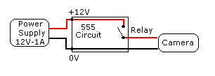

Hi there pebe hope you enjoyed Christmas, finally after all the hassle I can concentrate on this project again, I had been planning to just power the relay circuit separately, but if you say in conjunction with using a 12v relay I could use the camera power supply to power the relay circuit, how would I connect this up and would it effect the operation of the camera when on ??

I see from your first posting that the power supply for the camera gives 12V at 1A. From its physical size it must be a switch-mode type which gives a stabilized output. So it will happily give the extra power required for your circuit and relay.
Here's how to wire it up. Cut the 12V lead from the power supply and connect the ends like in the drawing. Then the 555 circuit is permanently on, but the camera only comes on when the relay is energised.

Hi there pebe, sorry it has taken me so long to get back to you on this circuit, just want to say thanx for all your help, it is all installed and working perfectly how I want it to.
