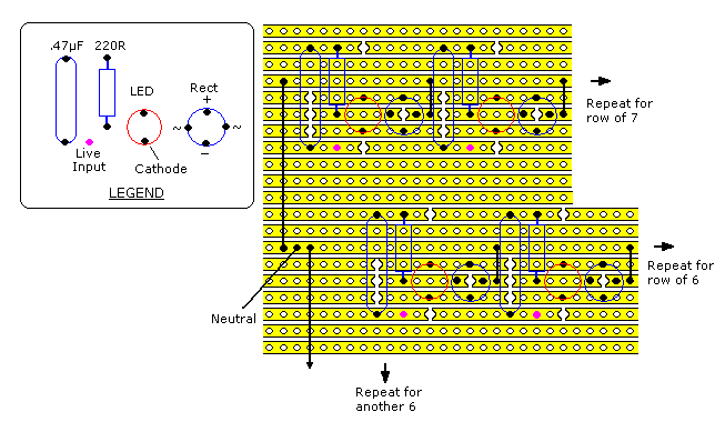

Postby pebe » Tue Jan 28, 2014 5:03 pm
OK, here it is. I have arranged it at a 1" x 1" pitch as you requested.
I think it should be self-explanatory. If not, just shout.
LED Display.GIF (11.95 KiB) Viewed 18348 times

Postby sargan » Tue Jan 28, 2014 6:27 pm
Thanks a lot ... what program did you use ? good to know

Postby pebe » Tue Jan 28, 2014 7:34 pm
No program. Done by hand.
