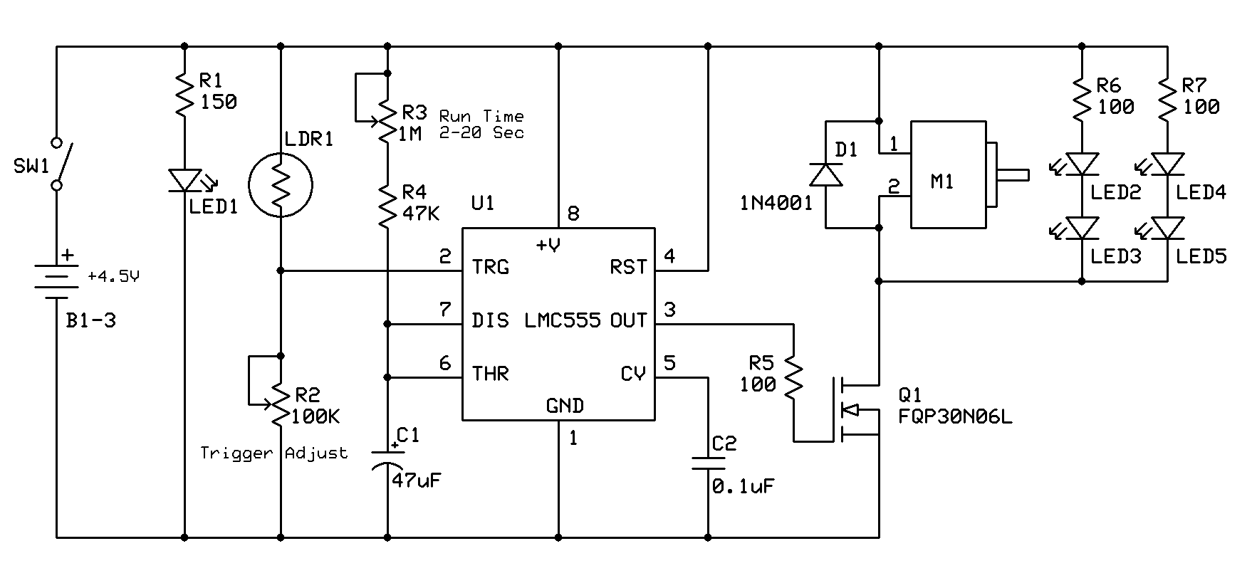

Hello. I am currently working on a circuit for a project I have created.
I need help with creating my circuit. I want the circuit to rotate an object for 10 seconds whilst four LEDs are on for 10 seconds too. I want the circuit to be activated by a LDR and a button. The LDR will be placed in a surface where a ball will roll cross so once the ball has crossed I want the object to rotate and LEDs to turn on.
Thank you in advance and if you have any questions please ask.

Do you have any spec's, voltage and current, on the motor you will use for the rotation? Is the start and end position of the rotated object important, or just 10 seconds of rotation? Is the purpose of the "button" to start the rotation in lieu of the LDR circuit doing it?

The motors' voltage rating is 1.5V to 4.5V and the max current is 1.17A. The start and end position of the rotated object are not important. I want the button and LDR to both trigger the object to rotate and LEDs to turn on for 10 seconds.

OK, an LM555 10-second monostable driving a N-MOSFET, that switches on and off the motor and LEDs.
What power source? Battery, wall wart, ...?
What LEDs. Different LEDs have different minimum voltage requirements and maximum current ratings.
What LDR, and what light source will illuminate the LDR.

It will be powered with a battery on a battery snap. The LED is the standard 5mm. Above the LDR there will be an LED that will always be on.

When someone says "battery snap" I assume they mean a PP2 9V battery. Is that what you're intending to use? 5mm is a physical dimension. Bur, it sort of implies a ~10mA LED current. What color do you intend for the 4x LEDs and for the LDR LED? That determines the LED voltage rating. How far from the LDR is the LED?

The battery is a standard 9V. The colour of all the LEDs are red and the LED above the LDR is about 1cm.

"...motors' voltage rating is 1.5V to 4.5V and the max current is 1.17A."
A 9V PP2 battery will not last long with that motor...like minutes...maybe. I would go with three AA-cell. C-cell or D-cell batteries, depending on your size limitations. Is that possible?

Postby KMoffett » Sun Dec 21, 2014 7:53 pm
OK, here is a circuit that should work for you. I have not bench tested it, as I don't know the specs on the LRD/LED sensor you may choose or how much current the motor will draw under you load.
