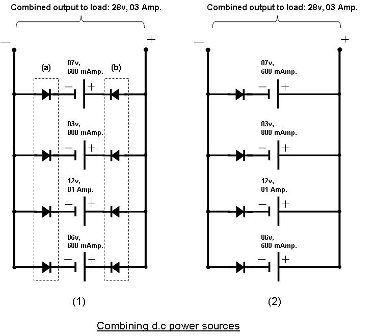

For understanding the CONCEPT Of ADDING MULTIPLE D.C POWER SOURCES TOGETHER to get a COMBINED OUTPUT and practically applying it, this question is asked here. It should not be bothered with, that, what is required to do with the given schematic, it's just a self-drawn schematic to confirm, or to be corrected, if needed, to understand the concept of the above mentioned.
Please provide correct answer/info for the above for adding multiple d.c power sources (it would be convenient if the needed answer/info is given as per following question order, with many Thanks.):
1. Which one of the above is correct, ( (1) or (2) ) ?
2. In the diagram (1) above, is the wing (b) of diodes really needed in the circuit, if it is correctly
attached as per schematic?
3. The d.c power sources are shown here are as rated chargers/adapters. If one of the above (or both) is correct, do the batteries (Lead acid, dry cell, and solar panels etc. ...) may also be connected as same as per subject, to prevent circulation of currents and charging each other?
* Any discrepencies, or detailed guidance in the aboves may be really appreciated for indicating.

Neither circuit is correct.
You cannot put different voltage sources in parallel.
