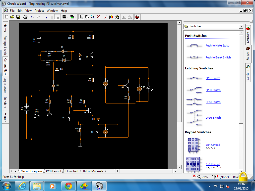

hello please help me make a breadboard version of this combinational logic circuit
I dont know how to do it, can someone please do it for me.
here is the circuit

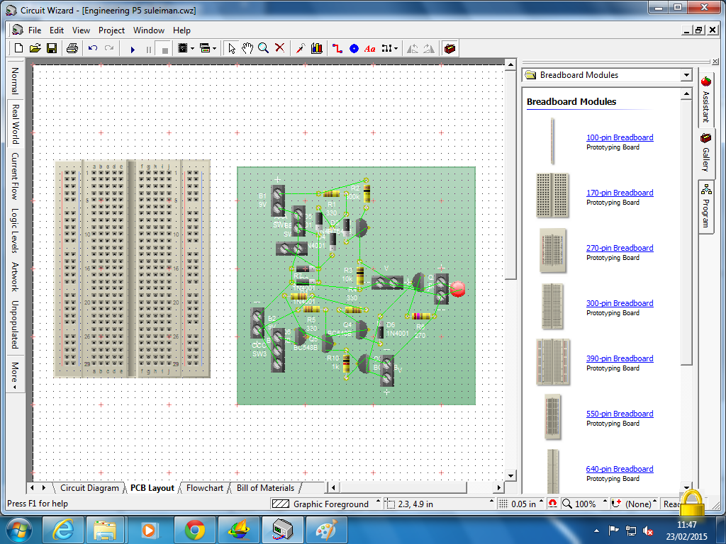

and here is the type of breadboard I need you to make me the circuit on.
PCB layout and breadboard P5.png (188.55 KiB) Viewed 7413 times
schematics p5.png (181.03 KiB) Viewed 7413 times

Postby pebe » Thu Feb 26, 2015 7:06 pm
What is the circuit supposed to do? At first sight it seems an elaborate method of switching an LED on and off.
Diodes D1 and D2 appear to be doing nothing, and the values of R1 and R2 seem to be reversed.
(Edit): Both batteries share a common -ve terminal, so why two batteries; you only need one.
