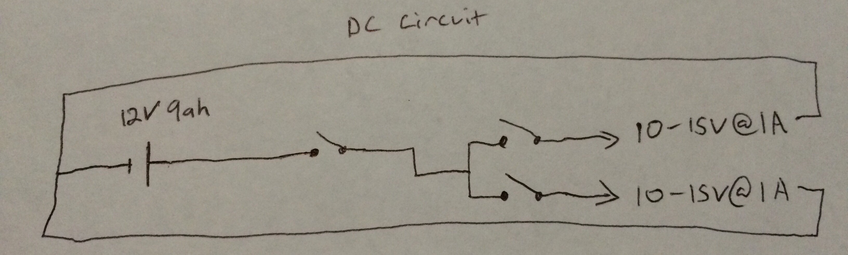

I am asking for some help with a little project I am working on. It is for my telescope so that I can switch the power on or off for up to 2 devices. One is the telescope GoTo system and the other is for the ability to use a few LED lights later on.
I have an enclosure which will house a 12v 9Ah battery and all the wiring and switches. What I wanted to do was has one switch to "turn on" the other two switches which will each power a device. I have attached a simple sketch of what I was thinking, it has been too long since I have done something like this and I don't want to fry anything.
Charging of the battery will be done when the main switch is turned off and a charger plugged in. The switches are all Earth/Load/Supply which have the ability to illuminate when the load is turned on.
I need help in relation to any resistors, regulators or layout to make sure the circuit is okay and will not damage any devices. Any other suggestions will be greatly appreciated.

Looks good so far. From what you've posted, all you have to do is connect the "Earth" terminals on all three switches to the negative side of the battery. The be sure, activate the switches with no loads connected. Then try it with safe loads, like 12V light bulbs. Are you thinking of having an automatic disconnect, so when the charger is attached the main switch is disabled?
