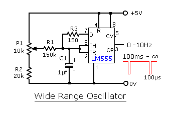

Here is a suitable circuit.
With the wiper of P1 set to the top, the charge time will be 0.69 x R1 x C1; around 100ms. The discharge resistor R3 gives a negative pulse width of about 100µs. Changing R3 changes the pulse width pro-rata.
Pins 6&2 swing between 1/3 of supply and 2/3 of supply. Taking P1 wiper more negative reduces the current through R1 and so increases the charge time of C1. Taking Pi wiper progressively more negative will result in the oscillator running slower and slower until when it gets down to R2 (pin6 = 2/3 supply) it will stop altogether.

Re: Low freq 555 trigger circuit via potentiometer
Postby JMACgyver » Tue Apr 05, 2016 4:13 pm
Thank you, sir!
I will wire it up first chance I get and see what happens.
Sounds like it does what I'm looking for, but just have a few follow-up questions.
-Where would I connect R3 instead, if I wanted a positive pulse (pull-up instead of pull-down)?
- If I wanted the pulse to stop midrange of the pot, then I would have to choose R2 to be equal to half the total pot resistance, correct?

[quote]Where would I connect R3 instead, if I wanted a positive pulse (pull-up instead of pull-down)?[/quote]
That particular circuit gives a negative pulse, and it cannot be changed. But you can add an inverter.
[quote]If I wanted the pulse to stop midrange of the pot, then I would have to choose R2 to be equal to half the total pot resistance, correct?[/quote]
Correct. With R2 = 5k the slider at mid-travel will have the correct 2/3 supply voltage.
The Hall-effect will switch on when the magnet passes it. You will need to establish where in the circuit the Hall-effect is fitted. If one side connects to 0V (most likely) then the negative pulse is what you want. If one side connects to +5V then you will need to change it to a positive pulse. Use any NPN small signal transistor and connect its base via a 10k resistor to 555 pin3. Connect its emitter to 0V and connect a 10K resistor from its collector to +5V. You can then get a positive pulse from the collector.
If the Hall-effect is fitted to some other point that is neither 0v or +5V, then you will need to use an opto-coupler. More details on that if you need them.

:D Thank you so much for your help! It works exactly as intended. Once I adjusted the values to correspond with the actual devices being used, it does everything I needed it to do. Thank you again! You are amazingly knowledgeable. :D
