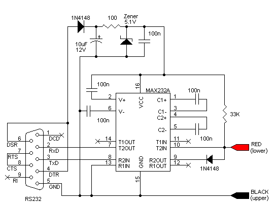

I need some help with the parts list of the following schematic and i dont want to buy the wrong things if any one can help that would be great, Thnx
interface schematic.gif (6.64 KiB) Viewed 7967 times
