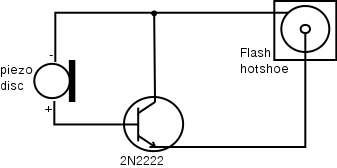

Hi All,
I'm an absolute rank amateur at electronics (although I did A Level physics 20 years ago!) but a keen photographer and thought it'd be good fun to build an audio flash trigger to capture balloons bursting, etc.
I started with this:
but the piezo disc was nowhere near sensitive enough, only rapping it with a pen would cause the flash to fire.

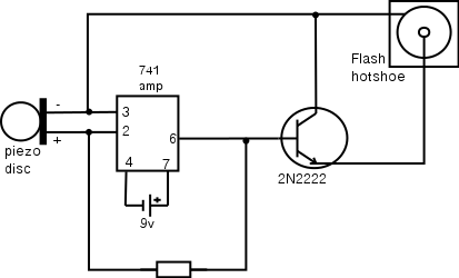

My second attempt added an 741 op amp to try to boost the piezo signal, but the same problem remains..

1. The piezo is open cvircuit as far as DC is concerned, so the 2N2222 has no forward bias. So base current would not flow unless the piezo volts exceeded 600mV. If the piezo output was high enough, the transistor would even then only turn on during spikes. It is likely they would not be on long enough to operate the circuit. It may improve things to fit a 100nF from collector to emitter to hold the collector low between spikes.
2. The outout of the 741 (pin6) needs to be normally at less than 0.6V so it does not trigger the 2N2222. As pin2 will follow pin6, it also needs to be <0.6V. But the 741 needs pins2 & 3 to be at least +1.5V relative to pin4 - so the circuit cannot work.

Postby newcube » Fri Jan 27, 2012 4:32 pm
Thanks for the info. Knowing [i]why[/i] components are used is extremely useful. Do you know any place on the web that explains circuits in this way (you should teach this stuff!)
