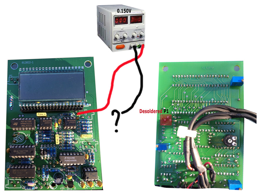

1-)With DMM i could measure IC5 and IC7 components +- 5 volts.
2-)I desoldered P1 and
3-)I set the power supply to 0.150 V and attached one of the crocodile connecter to TPA but i don't know which part the other one will be connected?And which part is GND on the circuitboard?
4-)Do we need to fallow exact adjustment part 2? Which has needed some oscilloscope and frequency counter measurments?
Thanks a lot

Ground is any of the many places where you can see a thick horizontal bar at the bottom of a vertical connecting line, eg. pins 3 and 6 of the ICL7660.
I am afraid you will need an oscilloscope or a frequency counter to carry out the calibration if you want the meter to read accurately

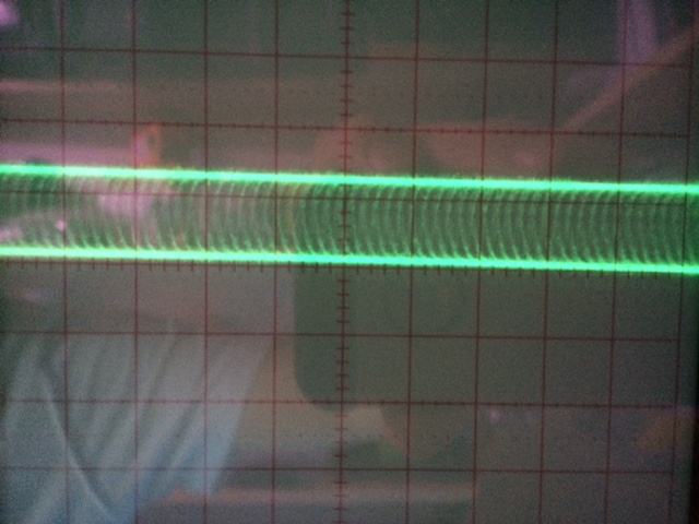

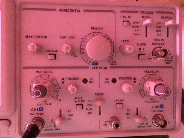

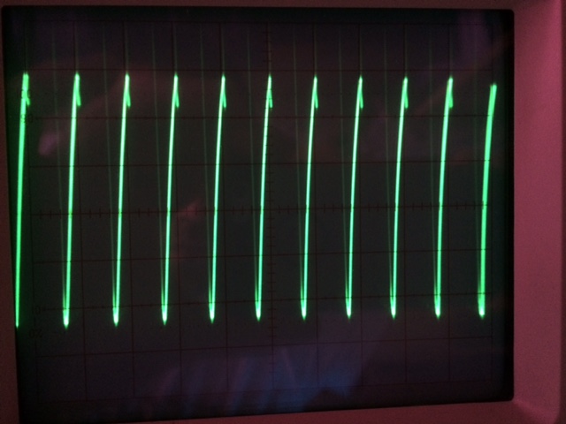

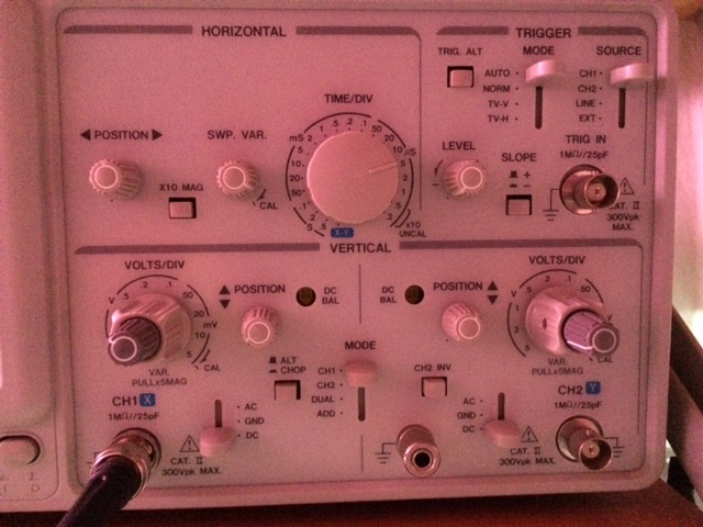

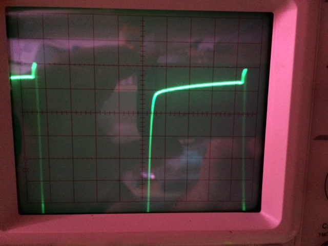

Postby savetheday » Mon May 11, 2015 10:16 pm

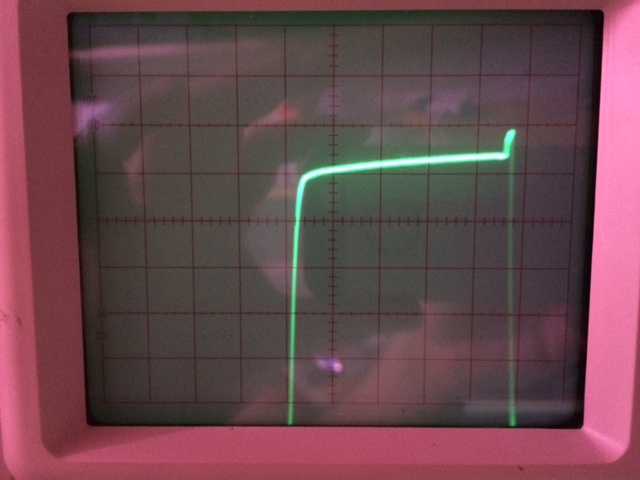

I'm geting this figure.How do we set 200 kHz?There is only time/div and volts/div ?
[attachment=2]
savetheday
Posts: 14
Joined: Sun May 03, 2015 9:23 pm
Re: Esr meter adjustment

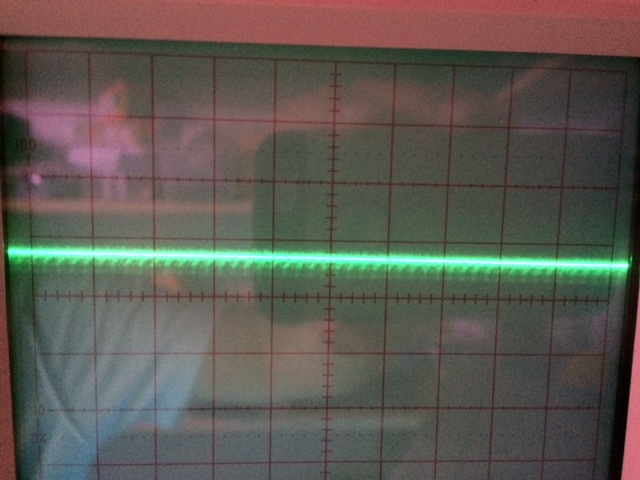

Postby pebe » Tue May 12, 2015 11:15 am
You are looking to measure the ‘period’ of the waveform, which is the time interval between successive cycles. In your top photo, you can measure the period as the time between the trailing edges of two consecutive pulses.
If you took that photo with the scope set-up as in your last photo, with time per division equal to 5uS, then the period is 10 divisions so at 50us is far too slow.
So switch the scope to the 1us/div range and speed up your oscillator until the period equals 5 vertical divisions of the graticule.

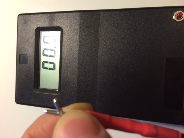

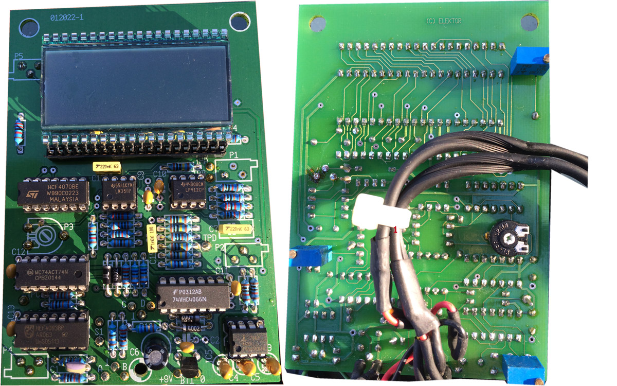

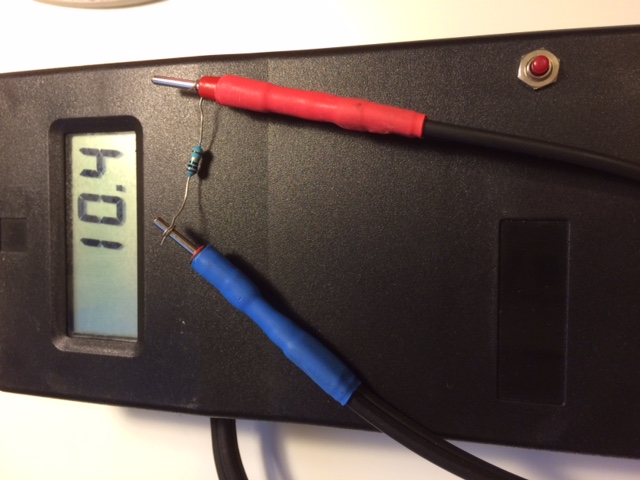

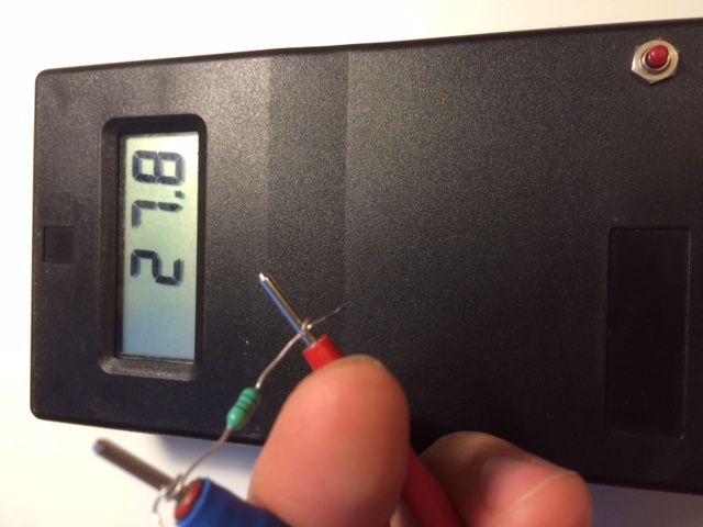

Postby savetheday » Fri May 15, 2015 8:53 pm
I did every thing and i guess it's working now.But i checked with 3 ohm resister it reads something like 27.8 or 32 And with 10 ohm resister 10.4
It's not bad.I'm going to use like that.
Thanks a lot
[attachment=4]
[attachment=3]
[attachment=2]

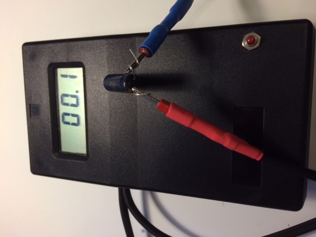

Postby savetheday » Fri May 15, 2015 8:54 pm
and those.
