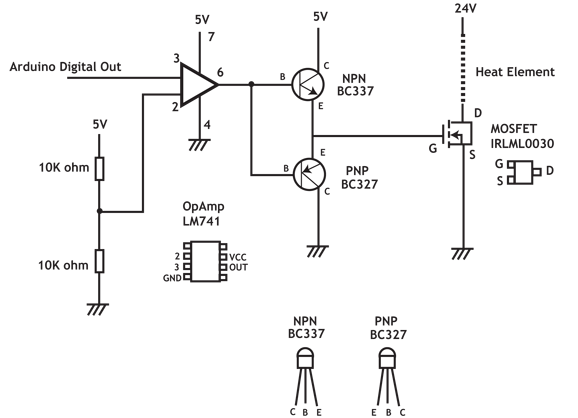

Postby sawadeejar » Tue Apr 05, 2011 3:08 pm
Dear all,
Anyone has an idea how to build heat generating circuit with 9v battery?
This schematic found at [url]http://www.kobakant.at/DIY/?p=2909[/url] using 24v supply. I wonder how to modify it to work with 9v instead of 24v power supply.
Thanks.
sawadeejar
Posts: 6
Joined: Mon Apr 04, 2011 10:48 pm

Postby sawadeejar » Thu Apr 07, 2011 9:07 am
[quote="pebe"]What sort of 9V battery? How much heat to you want to get from it?
[/quote]
My first plan was to use PP3 V9 battery but I've realised that it's not powerful enough to create required heat 15 - 40 c degree. Note: the heating element is conductive thread (12Ω/foot)
The circuit will be embedded in clothing so the power source should be lightweight and portable. What type and voltage of battery would you recommend?

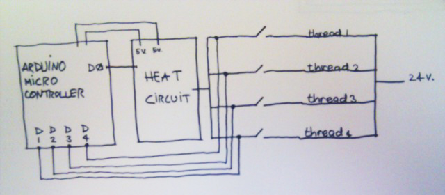

Postby sawadeejar » Thu Apr 07, 2011 7:32 pm
[quote="pebe"]Re. the switch option, I noticed the circuit you were considering went to great lengths to switch on power to the thread stuff, and wondered why you did not use a simple on/off switch.[/quote]
I've planed to use switches as seen in the attached picture. Each switch is waiting for the controller to trigger so 1 heat circuit can be used to supply heat to multiple threads at the same time and different time.
Is this a good plan?
sawadeejar
Posts: 6
Postby pebe » Thu Apr 07, 2011 7:47 pm
You have four manual switches. How do the outputs from D1-D4 do any switching?
Postby sawadeejar » Thu Apr 07, 2011 8:07 pm
D1-4 outputs will be controlled as high or low. High --> turn ON, Low --> turn OFF.
sawadeejar
Posts: 6
Postby pebe » Fri Apr 08, 2011 5:39 am
Your outputs from D1 to D4, going to the output of the heat controller and feeding all of the manual switches connected together makes no sense at all.
Postby sawadeejar » Fri Apr 08, 2011 6:29 am
You are right.
Is there a way to control each heating element separately?
I only can think of using 4 heat circuits connented to the microcontroller.
sawadeejar
Posts: 6
Postby pebe » Fri Apr 08, 2011 6:37 am
What does the Heat Controller do?
Postby sawadeejar » Fri Apr 08, 2011 8:35 am
To generate heat.
I think that it's needed because i also want to control the temperature at certain degrees.
sawadeejar
Posts: 6
Postby pebe » Fri Apr 08, 2011 1:47 pm
So what is it supposed to do? How is it supposed to control the switches?
Sense for Zero Cross

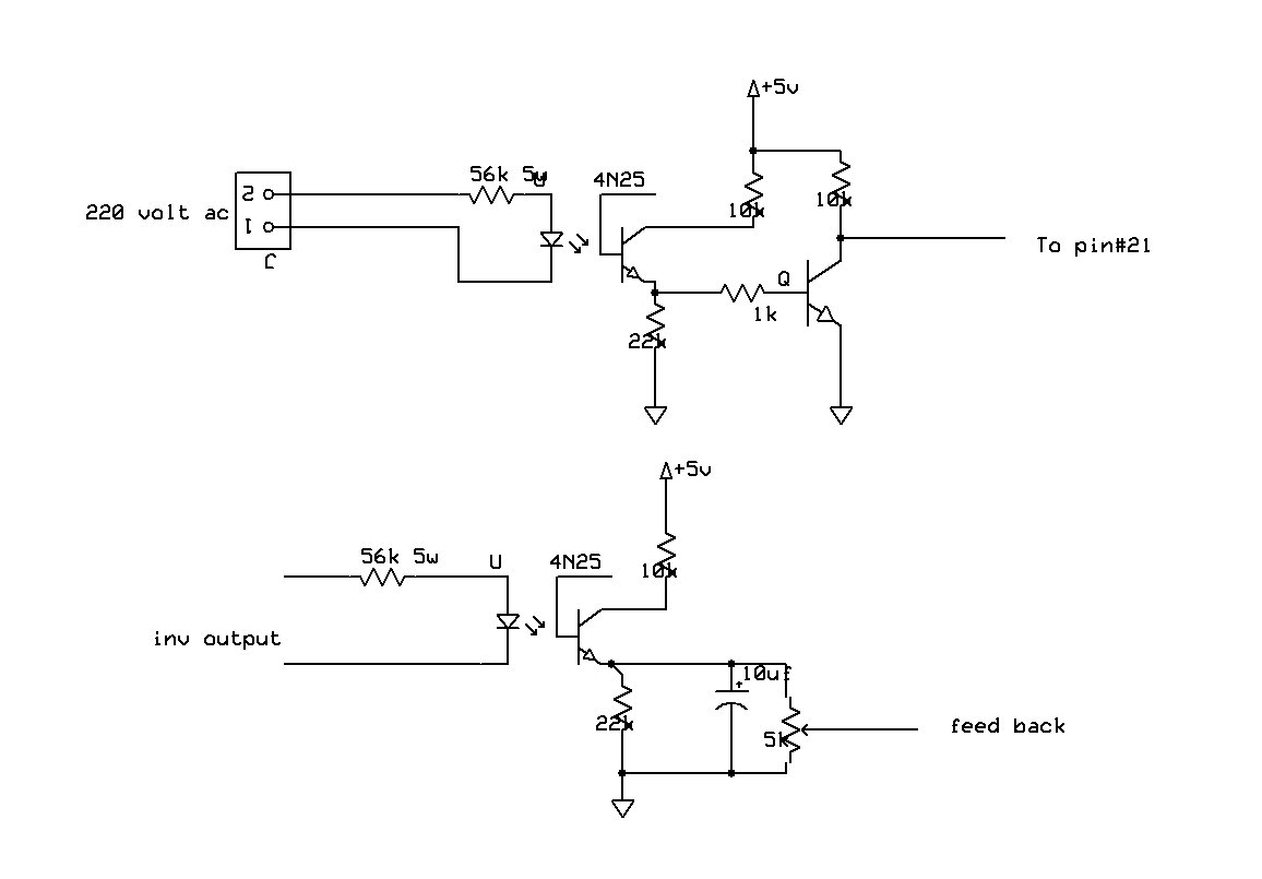

Postby ttom » Tue May 17, 2011 11:44 am
Circuit to sense the voltage and it's zero crossing
