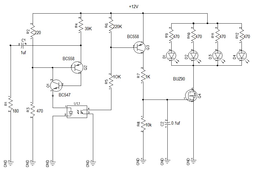

is there some type of strobe device that adjusts the frequency by a sort of dimming of power? im building a simple dmx led strobe that controls the strobe by dimming the power to some sort of solenoid or whatever controls a strobe.

heres a simple strobe using hi brightness leds.........
