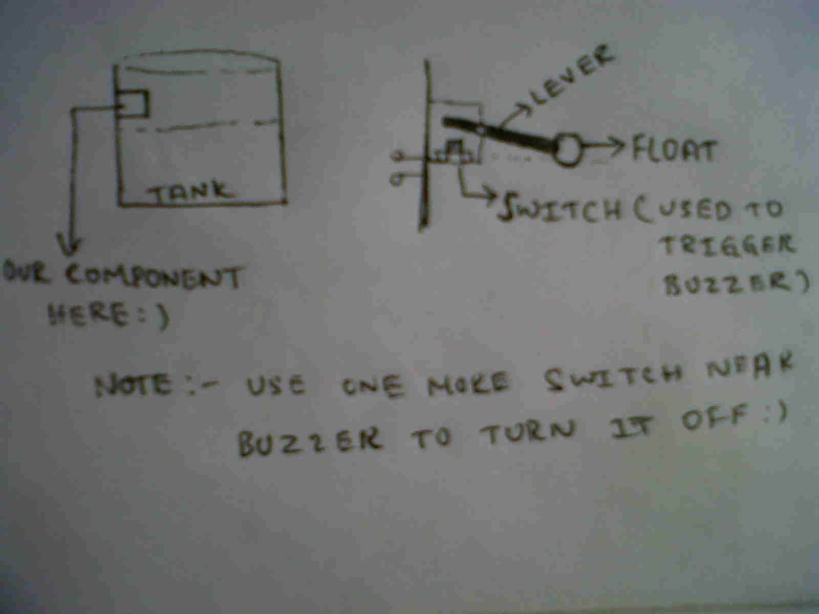

Postby sunilsuta » Thu Jan 31, 2013 11:43 am
This is the simple method I feel..u can use any old door bell..or if ur a silence lover then u can a relay to switch off the pump automatically!
Block diagram here:)

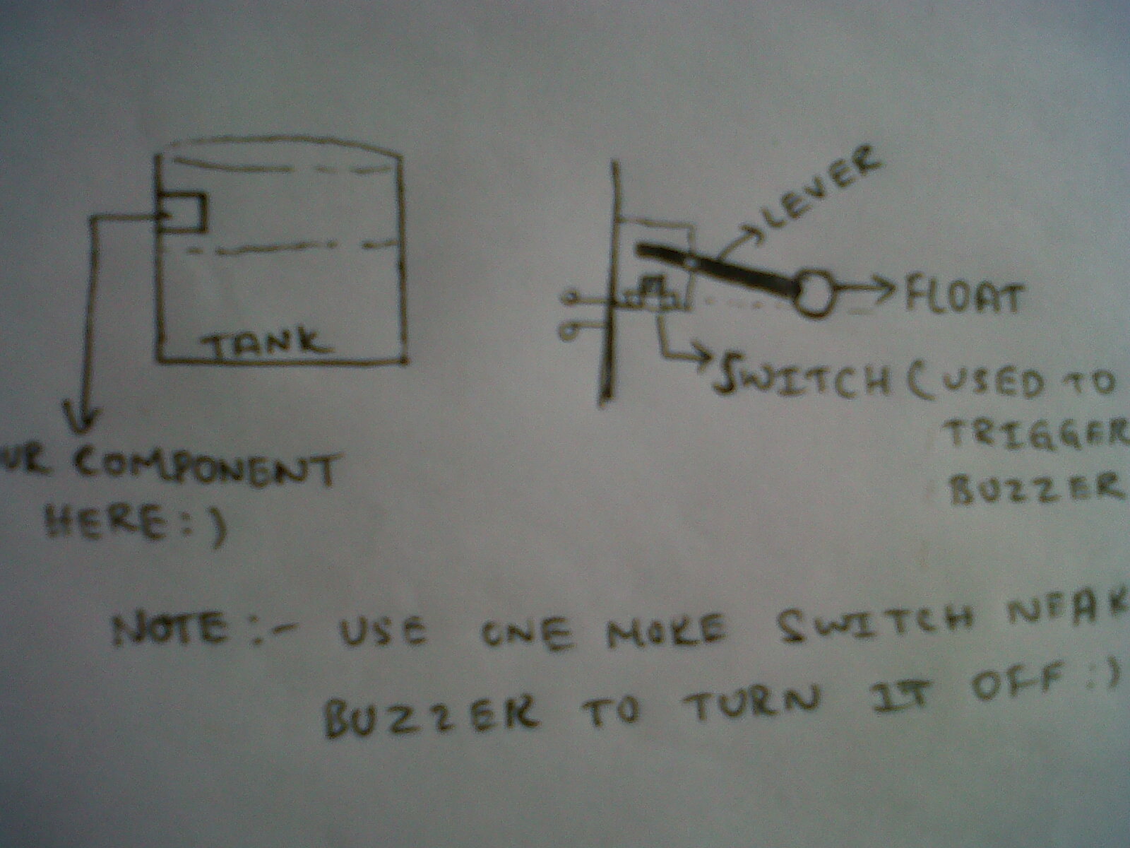

Postby sunilsuta » Thu Jan 31, 2013 11:49 am
Sorry for my previous image upload.
