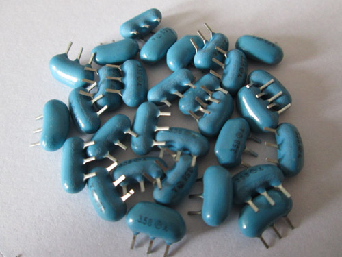

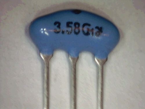

I have a last question :) .So this esrmeter works with 3 pins.I thing i better use 3 pins resonator.
Is it convenient to use 3 pins like CST3.58MGW300A? If i'm not wrong only differents with 2 pins,3 pins resonator has integrated caps.Thats all ! ?
My question is "Which one would you recommend me to choose under below?"
CST3.58MGW300A
ceramic resonator CST3_58MGW300A.JPG (16.37 KiB) Viewed 41961 times
CST3,58MGW
ceramic resonator 3,58 Mhz 3pol with cap CST3_58MGW.JPG (74.29 KiB) Viewed 41961 times
Aren't they similar?
By the way: i ask whom sells EVB "he said that it should work fine.when i use MKII Australian circuit .For Blue esr I might compare both circuits.Because MKII has the same firmware with mine.
Thanks a lot.
savetheday
Posts: 14
Joined: Sun May 03, 2015 9:23 pm
Re: selfmade esr meter
Postby pebe » Fri May 29, 2015 3:11 pm
A 2pin resonator is often used as an oscillator, but needs a capacitor of about 22pf-27pf connected to ground at each end of it. A 3pin resonator has those two caps built in and connected to the centre pin.
From the PCB layout it can be seen that that circuit requires a 3pin resonator. Looking at the two resonators you have shown, in the absence of any more information there is nothing to choose between them, so you can use either one.

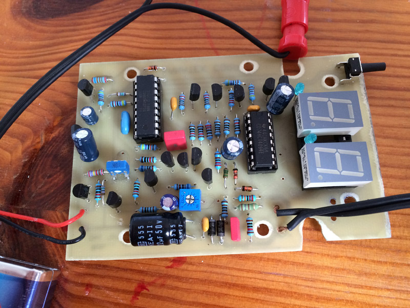

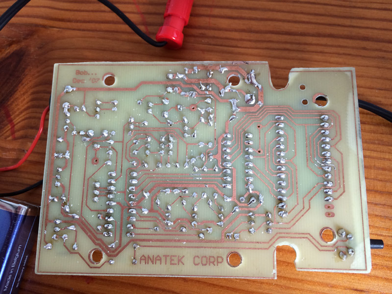

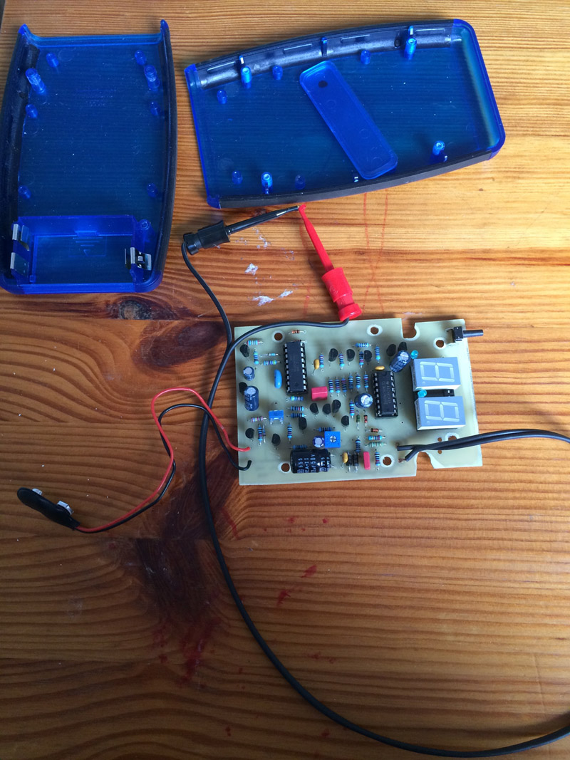

Sorry for my late reply.Finally, I have almost finished my Blue ESR Meter.First of all I have learned how to etch pcb's and then bought cheap components.
After all I have a working Blue ESR Meter.But when I touch two test leads together or test caps it automatically shuts off.What could be the reason?
savetheday

Postby savetheday » Sat Oct 03, 2015 2:54 pm
Ok i did it.First i assume that one of the cap is bad but I read one more time pdf file and I have to adjust 9V battery with VR1 VR2 so its working now.
