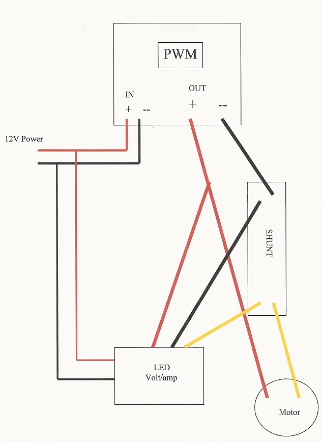

I built a slotcar test bench test cars at different voltage. I used a PWM with a pot attached to adjust the speed of the motors it works great by it's self but when I added a digital volt/amp meter in between it no longer adjusts speed, its full on and the volt meter don't work right. can the two be used together and if so how do I wire them. bellow is a pic of how I have it wired. any help would be great

If you look at the wiring diagram in the eBay link you see that the power supply to the load (POWER) and the power supply to the meter (DC4-30V) are not the same. This a very common arrange for this type of meter. The meter supply must be isolated, like a separate battery, from the supply to your load.

wow Ken thanks!!! I isolated dc4-30V power by using a 9V battery on a breadboard copy of my original project and it worked fine. I will apply this to my original project tomorrow and see if its the fix I need, but I think it's going to work. Thanks again Ken

I used a 9V battery to supply the power to light the volt/amp meter but it still don't work right. im concluding that you can not measure volts of a PWM because even when I put my hand held meter on it the volts don't read right. I am guessing that maybe its because the output is no steady but a pulse...any sugestions

PWM output is either full voltage or zero. As is the current flow. The relative on/off time is the variable. A meter with a long enough time constant relative to the PWM frequency it will read the Average voltage. Why do you want to read the output voltage and current of the PWM signal?

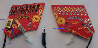

untitled (2).png (56.14 KiB) Viewed 40249 times
experienced racers use more expensive circuitry
