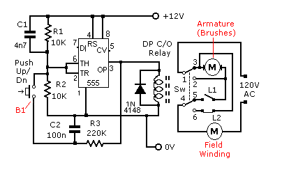

Postby pebe » Fri Aug 30, 2013 1:49 pm
I think I got the details of your motor OK. Here is the circuit and it’s about as simple as you can get. It uses a relay to reverse the polarity of the armature (the winding with brushes) relative to the field coil (fixed winding) of the motor. You will need a 12V supply.
First, the relay driver. A 555 is used in its bistable mode like this: Pin2 is connected to pin6. When pin2 is taken below 1/3 of Vs (the supply voltage) the output pin3 goes high, turning on the double pole changeover relay. When pin6 is taken to above 2/3 of Vs the output goes low turning off the relay. When pins2 & 6 are taken to ½ of Vs (R1=R2) there will be no change of output and it will remain in its previously commanded state. Pins5 and 7 are left unconnected.
Now how the 555 toggles. Assume Vs = 12V. When the 555 is first switched on, C1 is discharged so as Vs rises, pin6 is taken to Vs and pin3 goes low. Then C1 charges up via R2 so the voltage on pins2 & 6 is 6V. C2 is discharged so the voltage at B1 = 0V. When the push button is operated, C2 pulls down pin2 to 0v and sets the bistable, taking pin3 high. Now C2 charges up via R3 until the voltage at B1 reaches the pin3 voltage (about 10.5V). When the pushbutton is again pressed, B1 voltage is impressed on pin6 and the 555 resets (pin3 low). C2 discharges via R3 to 0V and that’s where we came in!
Now for the relay and motor. The diode across the relay coil is the usual one to prevent spikes from the relay as it turns off. L1 is the bottom limit switch and L2 is the top one. Both are normally closed switches and go open when the motor gets to the end of its travel.
The contacts as shown are when the lift is lowered and at rest. L1 is the bottom limit switch. While the lift was going down L1 would have been closed and current would have flowed through Sw 1to 3, through the armature, through L1, Sw 5 to 4, then the field winding. When the lift hits the bottom, L1 will open cutting off the motor.
When the button is pushed again the relay turns on. Sw 1 makes with 2 and Sw 4 makes with 6. Current now flows through the armature winding in the reverse direction (making the motor go in reverse) and L2. The lift rises until it hits the top limit and L2 opens, stopping the motor. Meanwhile, as the lift rises off the bottom stop, L1 would have closed ready for the return trip. The next button press will turn off the motor and the lift will go down again. Note that if you press the button at any time when the lift is moving, the motor will change direction.
When you construct it, make sure you keep the 120V supply well away from the 12V one. When you are ready to go, set the lift halfway so that you can check the motor direction is right. If it isn’t, reverse the field winding connections.
I hope that’s clear, but if you have any queries, just shout.
555 flip flop.GIF (5 KiB) Viewed 50927 times

Postby pebe » Fri Sep 13, 2013 2:22 pm
[quote="holbrooka"]Okay, so it has taken me much more time to get to this than I had hoped! I have spent today figuring out parts and here is what I have in my shopping cart:.................
.........I wasn't so sure about the specs on the 555, the relay and the switches, but I think they will work.[/quote]
No problem with any of them. 1/4W resistors would have been adequate, but no problem with 1/2W ones.
I am not sure why you want a MOSFET. If your drill is for use on 12VAC it will almost certainly use a Triac, not a MOSFET.
The speed regulator will use a capacitor charged through a variable resistor. If you dismantle the drill you will be able to see the variable resistor attached to the trigger. You can measure its resistance with an ohmmeter and replace it with an external rotary potentiometer (or 'pot'). TAKE CARE! 120V can kill! Ensure you insulate the terminals and ground the case of the pot.
[quote]Also, regarding the 12v power supply, does this need to be ac or dc or does it matter.[/quote]
The supply needs to be DC, with the positive terminal connected at the '+12V' I have shown at the top of the circuit.
[quote]Finally, I have a remote control (from the garage door which operates on 24v ac, which I would LOVE to incorporate into this schematic. Is there any way I can make this a 24v ac system so I can just plug it into the system?[/quote]
I cannot answer that question without knowing a lot more about your 24VAC system

Postby pebe » Fri Sep 13, 2013 6:14 pm
Yes, that dimmer would do the trick. Why 4 terminals? Well, remember the intention was probably be assemble the unit in a box and connect it in series between the 120V supply lead and the drill or other device, so it's only necessary to cut the lead and connect the 120V to the 'input' terminals and the load to the 'output'. You can use it that way and short out the two leads going to the trigger control to make it ineffective.
Note that only 2 pins are actually needed in the dimmer - the triac input and output. The other two are merely a link for the neutral wire, so you can see it functions the same as your exiting trigger circuit.
