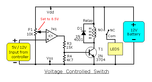

OK here's the circuit. Relay is 12VDC type and contact only needs to be single pole type. 'NO' is the Normally Open contact on the relay. You can use just about any type of op-amp if a 741 is not available - but do NOT use a comparator.
I think it is self explanatory, but shout if it isn't.

Ok I think it is a bit difficult for me to work out what's happening there. specially I am struggling with the PIN numbers on op amp. If you take my cartoon circuit and add the additional resistors and op amp there without internal circuitry that will be easier for me :mrgreen:
