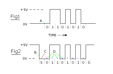

I assume you mean ‘how is it drawn on paper’. Sending a long string of binary bits is unwieldy and prone to errors, so data is normally sent in groups of 8bits called ‘bytes’. Alpha-numerics are represented according to the ASCII codes. The waveform of a byte consisting of 01101010 would be shown as shown in Fig1. The logic 1 level is shown as +5v, but it may be any voltage.

It’s all a matter of timing. The receiver must know whether data is positive or negative logic, the speed it is being sent at, and the starting point. In the case of Fig1 the receiver would not see the beginning of the first 0 (at A) because it is at the base level of 0V. The data line normally sits at logic 1 level (+5V) and data would be preceded with a ‘start bit’ of logic 0 (0V) to identify the first bit, A ‘1’ is also added as an end bit to ensure the line was high after the byte. So each byte would be sent as 10bits of data, as in Fig2.
This is how the receiver reads the data. To keep figures in nice round numbers, let’s assume a rate of 500bps. So each bit is 2ms long in time. Let’s also assume that the data is being received with a microcontroller.
The micro is waiting for the start bit to occur. As soon as it is received (B) the micro starts a 1ms timer. At the end of that time (C) the data will be half way through the start bit. The micro reads the level of the data at that time (known as ‘clocking in’ the bit). Then it sets its timer to give 8 periods of 2ms each and checks the data level after each 2ms period (D), to clock in the 8 bits. It then waits for the end of the stop bit (a ‘1’) and then looks for the next start bit and clocks in the next byte – and so on till the end of the data.
