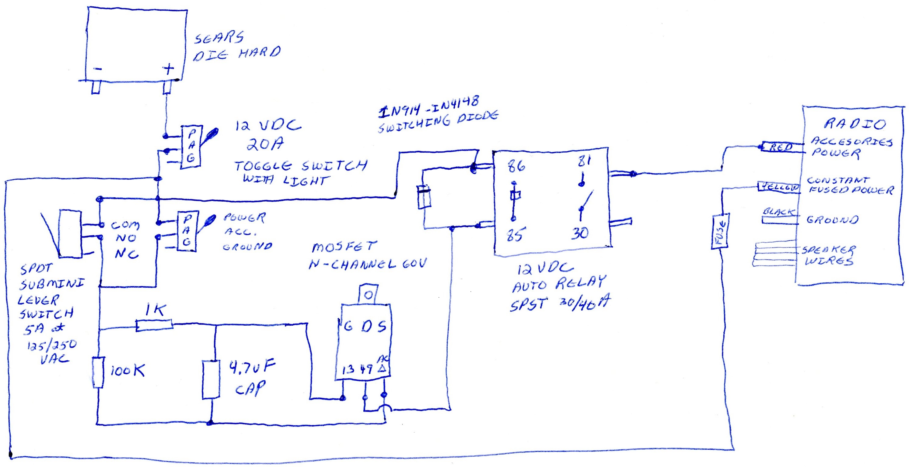

Well attached is a picture of what I have.
What I learned from the radio tech is that if I keep power to the yellow fused wire from the radio the radio will keep its memory. What I have to do is switch the power on and off to the red accessories wire. That is the wire that provides power when a car key is in the accessory or on position. Doing that will allow the CD to begin playing again from where it left off when the power is restored to the red wire. All hail the red wire!!!
Now my questions. I added a 12 volt switch between the battery and the circuit as a master off switch. Should I have a fuse between the switch and the battery to protect the circuit? I learned enough from my first test not to like burning wire.
Should the lever switch be updated to a 15 or 20 amp switch? They appear to be more durable than the little switch I have now.
I also do not think I have the relay wired correctly at all or have a good understanding of how it works. When I look online people seem to wire up the relays a little different every time to match what they are trying to accomplish.
My other question is what is to be done with the negative terminal of the battery. With my limited knowledge I always thought a circuit had to be completed either to ground or back to the negative terminal. My ignorance is showing now. :oops:

Postby KMoffett » Tue Nov 25, 2014 3:35 pm
Good score!Nice cabinet Brian.
1. Do you want the upper toggle switch to be lighted when ON? Same question for the lower one if it's also the lighted type
2. Do you care if the radio loses its memory when you turn the upper toggle switch (main power) OFF.
3. The upper toggle switch should be able to handle the radio current. Do you have a spec for that, like a recommended fuse rating? I'm guessing that a 20A switch is OK.
4. The lower toggle switch can be any one that is rated for 200mA or greater.
5. Your schematic is getting closer. I'll try to redo it, with corrections, today.

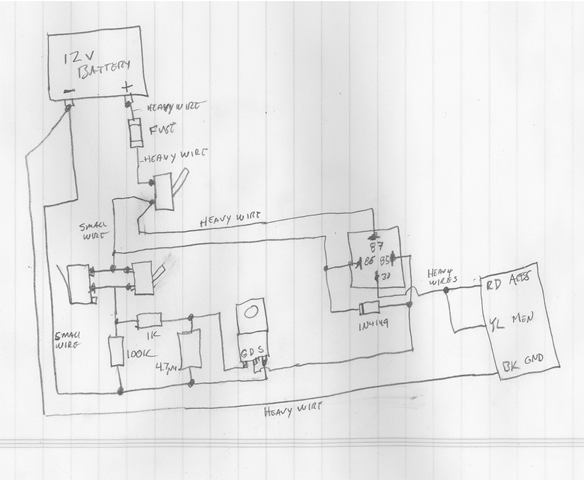

OK, here is what I see. Note the the wires for the timer circuit (small wires), and wires to the relay contacts and radio (heavy wires) as brought back separately to the power switch and the battery negative...not daisy chained.

I can wire that, but I have one question or two though as usual.
I intend to use 22 gauge solid wire for the small wire shown in the picture. What gauge should the heavy wire be?
The yellow lead from the radio should have constant power except when the main switch is flicked off and only the current to the red radio wire should be controlled by the circuit. If I connect the yellow to the red at the back of the radio then both would be controlled by the relay and when I stop cranking both yellow and red would lose power. Do I have that right?

Postby KMoffett » Tue Nov 25, 2014 5:44 pm
If the radio comes with a wiring harness use that size wire. Otherwise see if you can find the current draw for the radio.
Right on the memory wire. It should have gone to pin "87" on the relay.

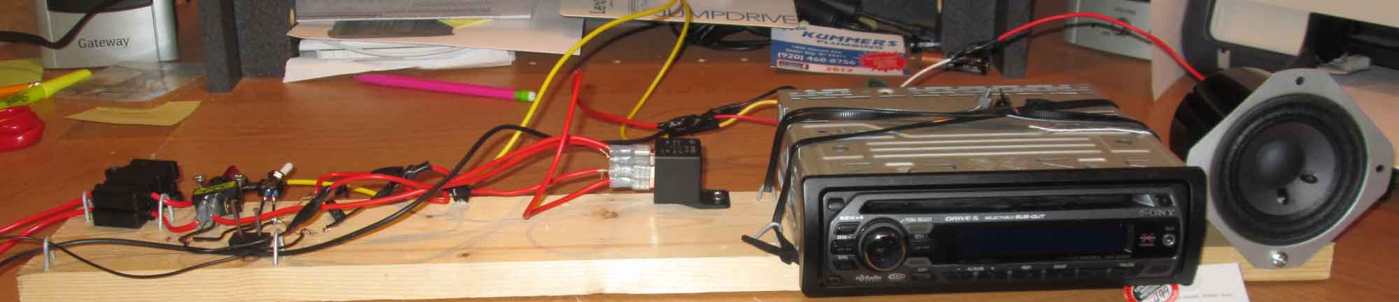

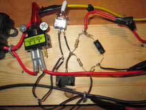

Postby windmillnut » Wed Dec 03, 2014 4:30 am
Well I built my breadboard radio based on the last schematic. I used 16 gauge stranded wire, but found out I could use 18 gauge based on the wire coming out of the radio. When I rebuild it again I will use 18 gauge stranded and 22 single strand wire. Well here it is with a $9 pawn shop radio and a $1 tweeter.
I have two inline fuses 15 amp one on the yellow constant power to the radio and the other to the master power switch. The master power switch and the override power switch will be exchanged for 20 amp versions. The lever switch is a 5 amp switch now and it will be exchanged for a 20 amp version which is a little stronger.
[attachment=3]
Meet the molested transistor. In the next version it will be wired using the 22 gauge wire.

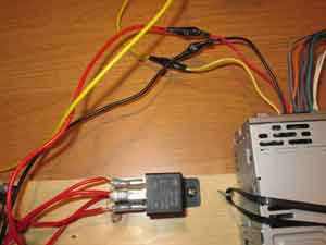

Below is the relay and diode. I have triple checked the connections and all connections have be soldered and wrapped with tape.
I have to get a couple of battery clamps tomorrow and then I will give it a whirl. This time though I will take it out to garage in case I smoke something.
I gauge my odds of success at 50/50. I will be sure and video the first switch on. This should be good!!!!

Well it worked! Thanks again Ken for the schematic. The master on off and the continuous play switches work. The lever switch also works. In order to keep the radio playing the switch must be closed twice a second. I would like to get it to once per second maybe even longer. I have to swap out the 1K resistor now to try and increase the period of time between clicks of the lever switch. OFF to the shack!
Most importantly when the CD starts playing a song again after the level switch was not clicked quick enough the song restarts where it left off!
One thing I did notice is that whenever the radio stops playing the speaker plays four beeps. It must be something with the radio doing it when the power to the accessories wire is turned off. I now have another question. The relay that I am using is a 12 volt auto relay to control the radio. If I want to cut the circuit to the speaker at the same time I do not think I can just link it to the same relay can I? The speaker wire appears to be about 20 gauge. Ken if I need another relay I may need another picture.
Regards and thanks again.

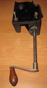

The next step is to reduce it in size and add the crank mechanism that will close the lever switch every second to keep the radio on.
