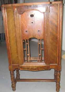

I also have some other news. A friend had a old radio cabinet that I think will work for the organ. I gave him lunch and now I have a small cabinet that I just have to modify a little for the organ. I think it will look great painted red with gold trim! It was a non working parts radio so I do not feel bad about re purposing it.

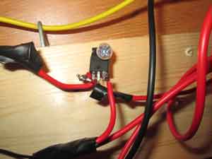

Well I built my breadboard radio based on the last schematic. I used 16 gauge stranded wire, but found out I could use 18 gauge based on the wire coming out of the radio. When I rebuild it again I will use 18 gauge stranded and 22 single strand wire. Well here it is with a $9 pawn shop radio and a $1 tweeter.
I have two inline fuses 15 amp one on the yellow constant power to the radio and the other to the master power switch. The master power switch and the override power switch will be exchanged for 20 amp versions. The lever switch is a 5 amp switch now and it will be exchanged for a 20 amp version which is a little stronger.
[attachment=3]
Meet the molested transistor. In the next version it will be wired using the 22 gauge wire.
[attachment=2]
Below is the relay and diode. I have triple checked the connections and all connections have be soldered and wrapped with tape.
I have to get a couple of battery clamps tomorrow and then I will give it a whirl. This time though I will take it out to garage in case I smoke something.
I gauge my odds of success at 50/50. I will be sure and video the first switch on. This should be good!!!!
