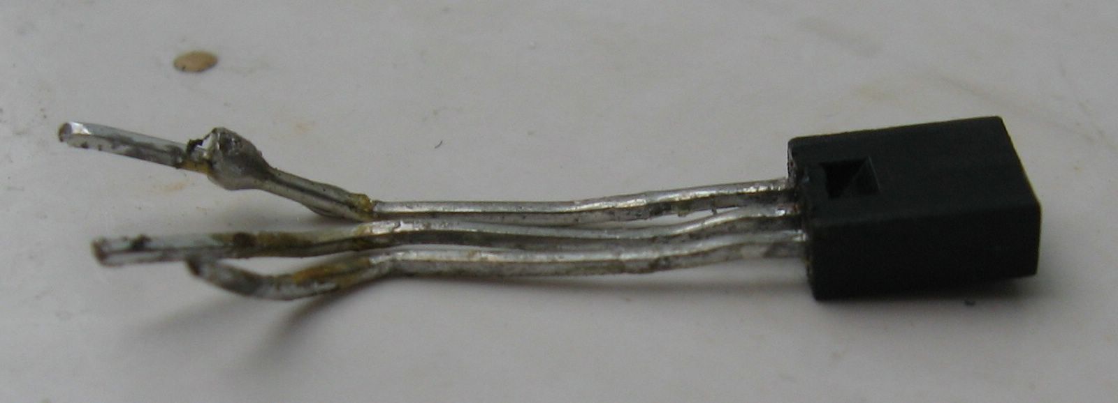

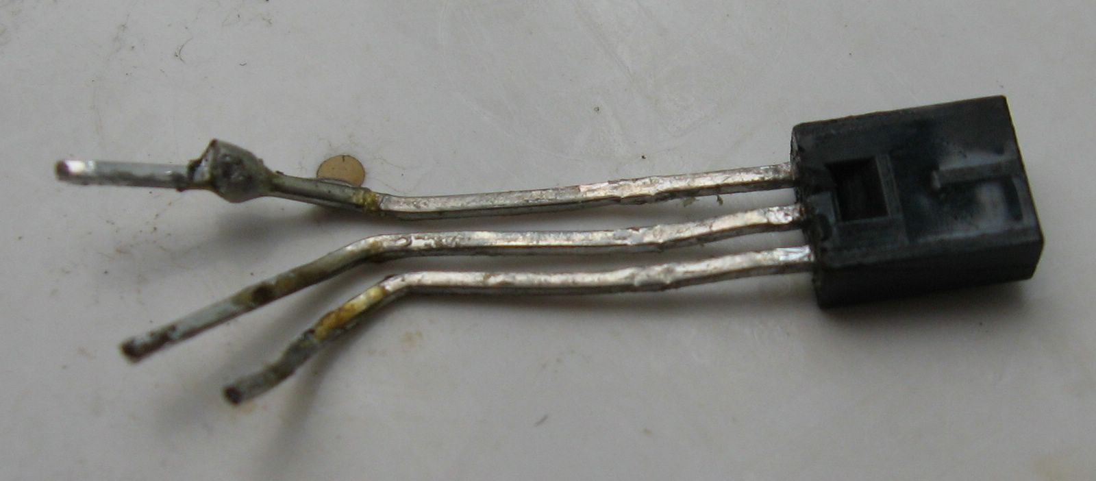

Postby ben39 » Tue Feb 24, 2015 10:46 am
Which part is this?
It comes from silva/nexus wind transducer unit.
In front of these sensor is a ball with black and white colors.
By good operation my measurement is:
pin 1: 10,5V
Pin 3: switch from 10,5V to 6V when the ball turns.
I 'am looking for a part number, that I can use as replacement.
replacement need to have same dimensions.
Dimension: front 4,6mm x 5,7mm side 2,3mm
Someone can help me with these?
Ben
sensor 1 [1600x1200].JPG (85.53 KiB) Viewed 33364 times
sensor 2 [1600x1200].JPG (65.73 KiB) Viewed 33364 times
ben39
Joined: Tue Feb 24, 2015 10:36 am
Re: Which part is this, see picture
Postby KMoffett » Tue Feb 24, 2015 6:43 pm
It's a reflective photo sensor.
Similar:
[url]http://www.alliedelec.com/honeywell-hlc1395-001/70019973/#tab=specs[/url]
[url]http://uk.farnell.com/honeywell-s-c/ss461a/sensor-hall-effect/dp/3111489[/url]
[url]http://www.jameco.com/1/1/5729-hlc1395-002-photointerrupter-linear-sensor-diffuse.html[/url]
Postby ben39 » Tue Feb 24, 2015 10:19 pm
Thanks Ken
looks like the same
