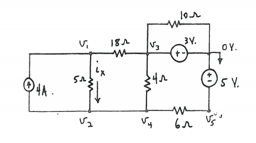

Im either missing something or have looked at the problem for too long and lost my mind... If anyone can help with the solution to this problem it would be much appreciated! :D

The v2 and v4 node is a natural reference. Why is that same node marked with two different names? Why is the node at the connection of the 3 volt and 5 volts supply set to 0 volts? How do you know that? The 10 ohm resistor in parallel with the 3 volts supply doesn't change any voltages or currents in the circuit. It just puts a load on the 3 volt supply. Remove it and do the calculations.
So, take a cut at solving and post your equations. Solve for nodes v1 and v3.
