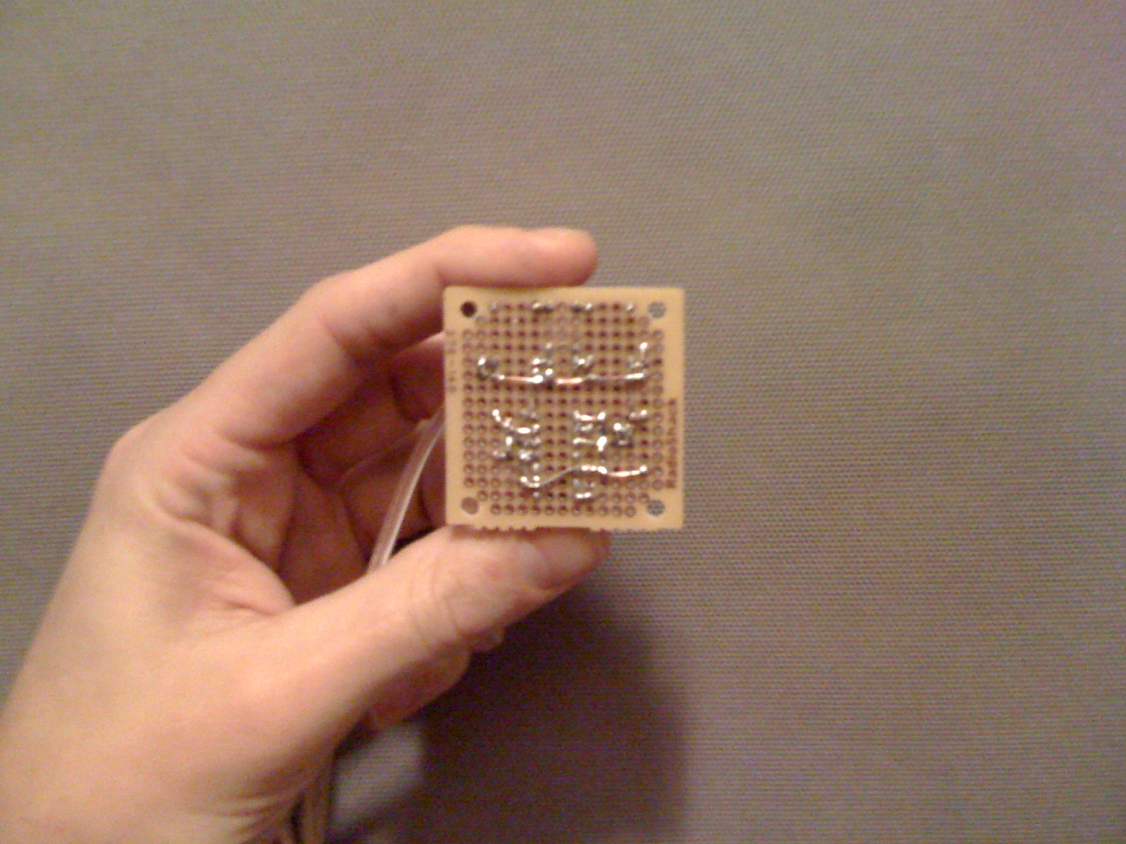

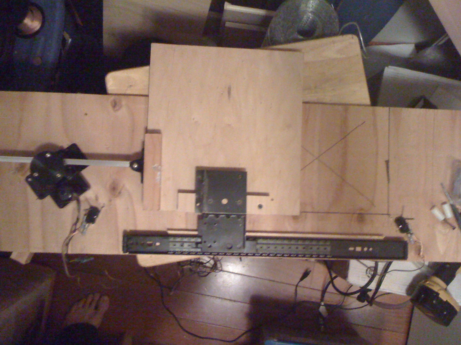

Postby bad coffee » Sat Mar 06, 2010 4:46 pm
Here's the setup, sorry for the awful phone pictures.
Door opener:(pics really big so I didn't want to link them)
http://www.bad-coffee.com/pics/door1.jpg
Top side of board
http://www.bad-coffee.com/pics/door2.jpg
Bottom
http://www.bad-coffee.com/pics/door3.jpg

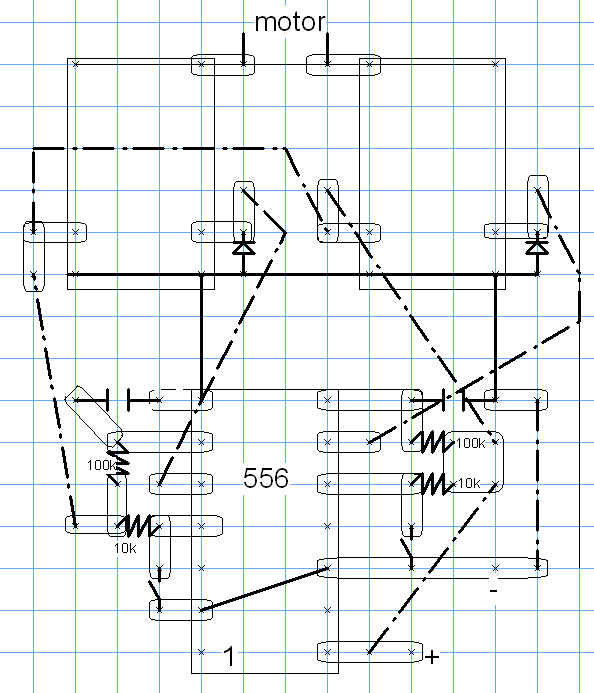

Here's my ghetto drawing.
It's bottom view, Solid black lines are jumpers underneath, dotted lines are jumpers topside.
The relays at the top, the coil is on the right, contacts on the left (top connectiors are common)
Circles are solder 'glob' pads underneath.
[img]http://www.bad-coffee.com/pics/picture_2.png[/img]
The motor is really close to a switch, so that might be the problem. I'll try moving the switch and see if it helps. However, it was the switch far away from the motor that wouldn't actually trigger the limit stop.
Thanks for the help.

Postby pebe » Sat Mar 06, 2010 5:21 pm
There is a small change I would make to the wiring layout. But first.
What are you using for a power supply? Is it well smoothed?

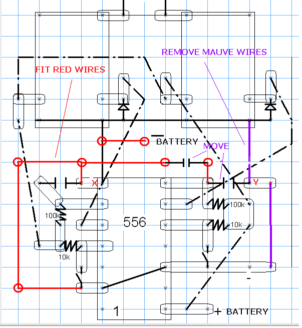

Postby pebe » Sun Mar 07, 2010 11:50 am
A likely cause is false triggering of the 556. As the board is wired at the moment, pin7 of the 556 receives its supply via the long wire from X to –Battery. The wire also feeds the relays and the motor. The ‘earthy’ end if the cap C1 is taken into the middle of that wire at Y. The higher impedance of the wire at that point makes the Trigger pin more susceptible to voltage spikes on that wire and from capacitive pickup from the O/P pin next to it.
You should provide a more direct connection for C1, and feed the –ve supply direct to pin7 by wiring it as shown.
The circuit is not fussy about a stabilised supply provided it is reasonably steady. If there is still a problem, fit a 470µF 25V capacitor as close to pins 7 and 14 (supplies) as possible.
556 mod.GIF (25.36 KiB) Viewed 169519 times

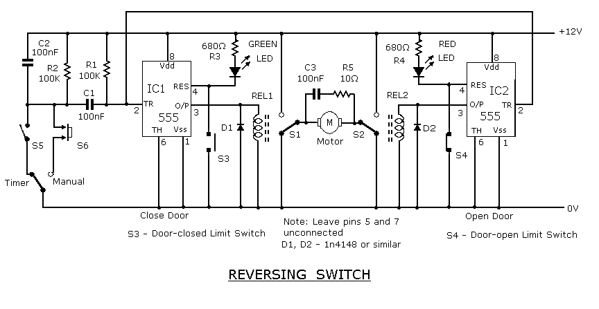

Postby pebe » Thu Jun 10, 2010 2:32 pm
Hi Brett,
The circuit given earlier in this thread would probably be OK for you. When the timer is off no battery current is being used. But switching the supply that way needs a timer switch that is on for at least as long as the door is opening so it would be no good for a momentary manual push button.
If you want, here is another circuit that will operate at just the touch of a switch, but the switch needs to make contact momentarily when the door is opened and again when the door is closed. A two way switch is shown to select timer or manual mode – just increase the number of ways to suit the number of switch types.
Both LEDs will be off when the door is moving, and the correct one will light when the door has opened/closed.
I cannot suggest a motor to use, because it depends on the opening mechanism. C3 and R5 may not be necessary but may be needed if there is a lot of electrical noise from the motor that may cause false opening. A stepper motor cannot be used.
As far as a charger is concerned, it would probably better to buy one of the types used for trickle charging car and caravan batteries.
555 Motor reverse 2.GIF (11.25 KiB) Viewed 169476 times
