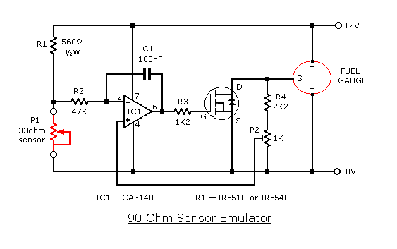

Postby pebe » Sun Jun 02, 2013 1:56 pm
Hi Ron,
I have found a suitable FET was the IRF510 or an IRF540. Here is the revised circuit.
The voltage between ‘S’ and ‘-‘ on the gauge should be zero for the gauge to show empty. These are the results with different types of transistor:-
The original 2N2222 brought it down to .78V (19% of full scale).
The IRF510 brings it down to .07V (1.7% of full scale).
The IRF540 is even better and brings it down to .01V (0.2% of full scale)
Note that the diode in series with the gauge has now been removed.
I hope you find this one OK.
Fuel Gauge.GIF (5.38 KiB) Viewed 34049 times
Re: resistance mismatch
Postby walnutron » Thu Jun 13, 2013 1:20 am
Hi Pebe,
The second circuit works very well. When I put it together the first time the needle went to full no problem, but I wasn't satisfied with the empty reading. TR1's (IRF 5140) output at S was 0.3V. Having two more in my kit, I changed it out. Now the reading is 0.01V (just as you said it would be) and the needle is on E when the sender is at 0 resistance.
Adding a circuit was the perfect fix because of the flexibility it gives me. Another plus was the learning curve I went through. I'm a gearhead; this was a stretch. I sincerely appreciate the contribution you have put into the project. You have been generous with your time and extremely helpful along the way.
Many thanks!
Ron.
