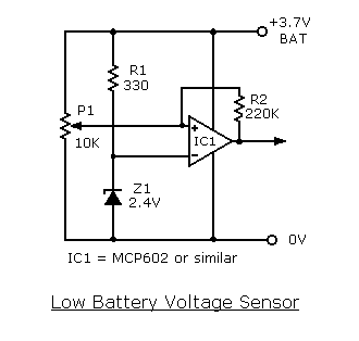

I am afraid your circuit will not work. The supply voltage is only 3.7V and that will not operate a 5V zener.
Here is a circuit that should work OK. Use an op-amp that will operate with a supply voltage down to 3V. Make sure it has enough output to drive your load.
The battery voltage rises slightly when the amp disconnects the load and that would make the amp try to turn the load on again. The process would repeat so the load would be continually switched on and off. To prevent that, the resistor, R2, is used to provide positive feedback to give some hysteresis. If it is not enough, reduce the value of R2.
When the battery has run down to the level for the alarm to trigger, set P1 so that the op-amp output goes low. Because of the hysteresis, there will be different settings of P1 for when the amp output goes from high to low, or from low to high.. The one you want is when the output is going from high to low.
