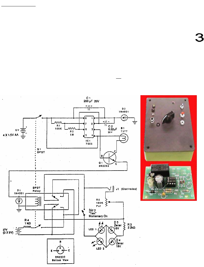

Dr Bob Beck uses a 555 timer to a transistor which switches the relay on and off. The relay is cross-connected and all the circuit actually does is swap the output from a 27 volt battery source. i.e The battery plus is connected to A and the Minus to B.
When the 555 output goes low the relay drops out and the battery plus is then connected to B and the minus to A
In other words if a motor is connected it will turn forward and then reverse, that is the same function as an H-Bridge.

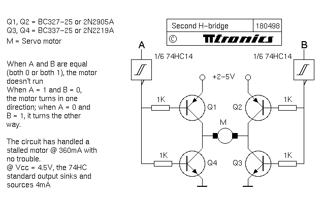

The H-Bridge I came across has two inputs. a totem pnp/npn transistor configuration on the left and the same circuit on the right.
My question is if I remove the switching transistor and the relay how do I connect, probably using two transistor to replace the 74HC14's (A and B) or direct to the1K resistors, to switch the H-Bridge on and off thus reversing the output. The output load is 30 to 100 micro-amperes so small transistors will do.

Postby pebe » Fri Sep 27, 2013 2:20 pm
As your load current is less than 1mA then this circuit should be OK for you.
Tr1 is an inverter that inverts the 555 output so that Tr4 and Tr5 are driven alternately. The bases of Tr2 and Tr3 are fed cross coupled from Tr5 and Tr4 collectors, so that Tr4 switches on Tr3 and Tr5 switches on Tr3.
There could be a brief time during switching when both complementary transistors are on together, but it would only last nanoseconds and the IK resistor, R4 in your circuit, would take care of any current surge.
