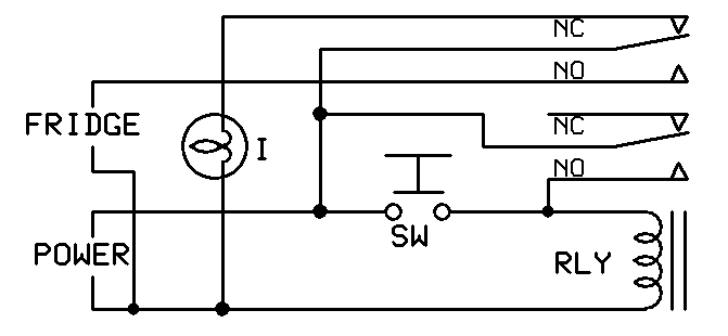

Postby KMoffett » Thu May 08, 2014 6:59 pm
A feature you might want to add...a warning light at the fridge, to indicate that the relay must be reset after the power comes back. see attached.
Fridge Cutout.gif (4.15 KiB) Viewed 16168 times
Oops. I changed the connections of the lamp/power/fridge on the upper relay contacts.
