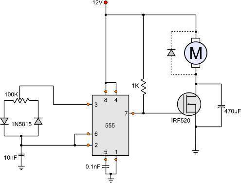

Postby sunny.sunman » Fri Apr 25, 2014 10:02 pm
ya. so would this work? if yes then is it an armature voltage control circuit cause i can not really tell if it is.

Postby pebe » Sat Apr 26, 2014 5:20 am
Your first circuit will not work because the current the 39ohms base resistor of the BD129 would draw would be on the maximum limit of the 555, and a FET makes a better switch than a bipolar transistor.
The second circuit is much better. The 555 oscillator is wired in the configuration I would use. You don't need the 470µF cap across the IRF520, - it defeats the object of using PWM. The diode across then motor may not be required because the FET has an internal diode which serves the same purpose.

Postby sunny.sunman » Sat Apr 26, 2014 3:56 pm
so is the second one an armature voltage control circuit?
sunny.sunman
Joined: Thu Apr 17, 2014 1:35 pm
Re: Speed control of a DC motor Using Armature Voltage
Postby pebe » Sat Apr 26, 2014 5:06 pm
The motor symbol shows a square block at each of its two terminals. I assume they are the brushes of the armature and that the field consists of a permanent magnet or a separate wound coil.
So, yes, I think it is an armature type of DC motor.

Postby sunny.sunman » Tue May 13, 2014 7:21 am
just to tell you the second circuit did not work like that. i had to swap what was on pin 7 with what was on pin 3 and it worked
sunny.sunman
Postby pebe » Wed May 14, 2014 6:23 am
I don't know why that should have been so.
Pin7 connects to an open collector of an NPN transistor. When Pin6 goes above 8V the transistor switches on, taking the FET's gate to ground and cutting it off. When Pin2 goes below 4V the FET the transistor switches off and the 1K from the gate turns on the FET.
So whenever Pin3 is low Pin7 is also low.
Postby sunny.sunman » Wed May 14, 2014 11:41 am
that should have been so, maybe there might have been a mistake in my connections.but it worked when i swapped it. anyway it worked and its done thank you for the help. :D
