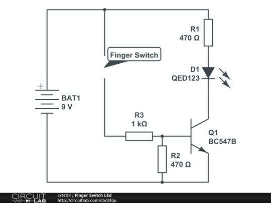

How can replace the push button with the finger touch circuit attached?

How can I replace the push button with a finger switch?

There are several ways of doing it. At the moment you are switching the feed to the timing elements of the 555. I think that way slows down the 'rotation' as it nears the end.
Is that so, and if so is it a feature you want to retain?
Can you tell me what is the in-circuit resistance of the pot connected to the base of the BC537C of your original circuit?
