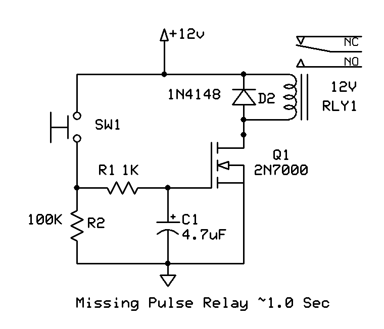

Hello,
I am looking to build my own version of a crank street organ. You know the kind with the guy and a monkey.
I plan on mounting a car stereo, speaker, and battery in a cabinet and rig it so that the radio plays either when someone is turning the crank or without if a switch is flipped.
The setup of the radio, battery, and speaker I think I can handle. What I cannot figure out is how to design a cadence detector to only allow the radio to play the music if someone is turning the handle. Does anyone know of someone that would design the circuit for my project for a fee? I only need one so to ask a big design firm to do it seem silly.
Any help would be appreciated.

Postby KMoffett » Wed Nov 12, 2014 4:54 pm
Are you thinking of switching on/off power to the radio, or just cutting out the speaker with the "crank" circuit. Cutting power to the radio my not have the radio automatically turned-on when power is reapplied. I can see a simple "missing pulse detector" circuit connected to the crank to detect if the crank is being turned above a minimum rate. This would switch a relay or solid state component to turn on and off the power or speaker.
Can't help with the monkey!
Re: Street Organ Help
Postby KMoffett » Wed Nov 12, 2014 9:35 pm
The attached is a simple missing pulse detector I've used. SW1 is a switch that would be pulsed on and off by the rotation of the crank. The mechanism would be determined by your mechanical design. If the switch is repeatedly pushed and released more often than once a second the relay will be turned on, and stay on. As soon as the switch rate drops below 1/sec or stops the relay will drop out. The 1/sec is just what I happen to have used in this circuit. It could be adjusted by changing R2 and/or C1.
A latching ON/OFF switch could be added in parallel with SW1 to maintain the relay on, bypassing the need to crank.

Postby windmillnut » Fri Nov 14, 2014 1:21 am
Ken,
Thank you very much for the layout. I stopped off at Radio Shack on the way home from work and picked up a few things.
Lever Switch 5aA at 125/250 AC
100k 1/2 watt carbon film resistors
1k 1/2 watt carbon film resistors
4.7uF Electrolytic Capacitor non polarized
1N4148 switching diode
SPST-12VDC Reed Relay .5A at 125VAC
and a mini lamp for testing 12volts 25mA
I still need to find the transistor 2N7000.
I never put together a circuit before so here come the questions.
Are the 1/2 watt resistors the right size they also had 1 watt resistors.
I have not purchased a on off switch yet. What should it be rated for?
What gauge wire do you recommend between the lever switch, on off switch and the rest of the components which will be mounted to a perfboard which I also purchased.
Also the lever switch has three connectors one of which I imagine is a ground. The circuit will be in a wooden cabinet so I have no way to ground it.
Also the relay I purchased has four connections. Two coil, a com and a N.O. I imagine the connections are made between the com and NO pins.
Thanks for you help!
Brian

Postby KMoffett » Fri Nov 14, 2014 3:29 pm
[color=#0000FF]This should work OK:[url]http://www.radioshack.com/mosfet-irf510-transistor/2762072.html#q=MOSFET&start=1[/url][/color]
[color=#0000FF]Yes.[/color]
[color=#0000FF]It can be any switch (maybe not tactile) as this is very low voltage and current.[/color]
[color=#0000FF]Small wire. Again, this is very low voltage and current.[/color]
[color=#0000FF]The switch has a Common, a Normally Open, and a Normally Closed contacts. You will use the Com. and N.O. connections. No ground.[/color]
[color=#0000FF]Yes. The Com. and N.O. will switch whatever you decided to switch. However, if you decide to switch the radio power supply, that relay's contacts will not handle the current. If you decide to switch the speaker, some amplifiers do not like to work (think smoke) with no speaker load connected.[/color]
[color=#0000FF]The timing determined by the R2 and/or C1 may need to be changed to meet your particular need. Doubling the value of R2 doubles the maximum time the relay remains on between input pulses (SW1). Halving the value cuts the time on half. The same goes for C1.[/color]
[color=#0000FF]Ken[/color]

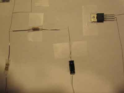

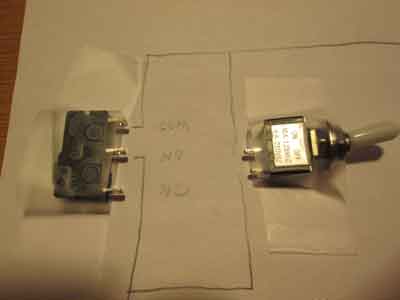

Postby windmillnut » Sun Nov 16, 2014 2:36 am
I am back from a trip to Radio Shack. I picked up a 12VDC Auto Relay SPST 30/40A, a spst mini toggle siwtch(10A at 126 VAC), and a IRF510 MOSFET transistor n-channel 60 volt).
I taped them all to a piece of paper to work out what I have to solder to what and of course I am troubled.
The first thing is the capacitor I had purchased indicates that it is a non-polarized capacitor while the diagram indicates a polarized one. I noticed the little plus sign.
I took a few pictures:
Shown is the trigger switch and the on off switch.
[attachment=2]
This shows the resistors, capacitor, and the transistor. I think my hook up of the transistor is wrong!
This shows the diode and the auto relay. Wires will go to terminals 30 and 47

Postby KMoffett » Mon Nov 17, 2014 4:03 pm
The non-polarized capacitor is OK. There some problems with the MOSFET and relay connections.
I did a quick Paint diagram of the correct connections. Sorry about the drawing quality. Pins 87 and 30 are used to switch whatever you intent to turn on/off.
