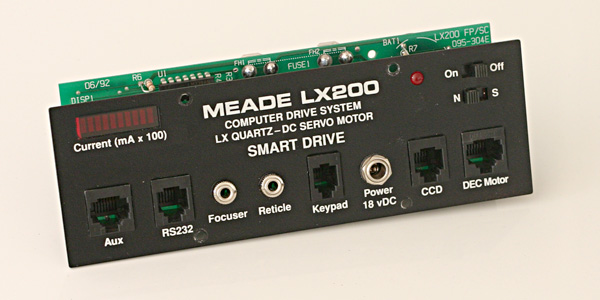

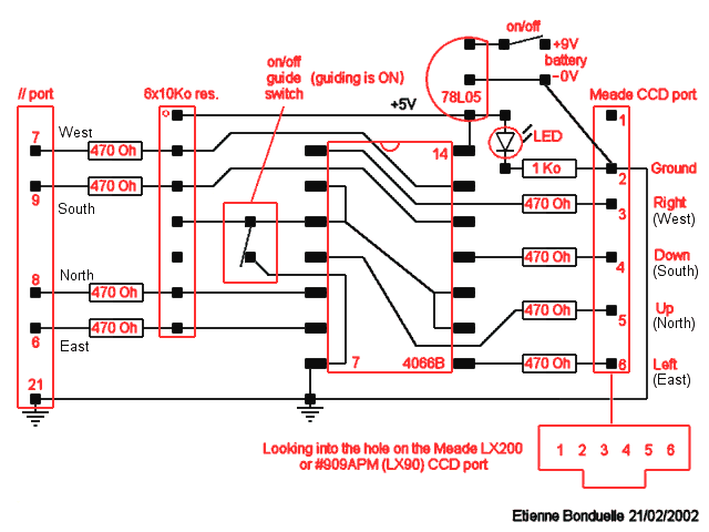

Attached are (2) diagrams, The red one is a CCD port in my robotic telescope, that ports primary function is for the use of an optional "guide scope" camera, which I've used over the years, it plugs into the CCD port via an RJ12 plug, mainly these guide cameras have 4 relays that tell the scope to manually move N,S,E,W for more accuracy tracking on a "guide star"
The other diagram is my joystick that I would like to plug into the port via the RJ12 plug connector/cable to manually move the scope. I've read that applying 5v or low as 3v+/-? to the 4066 would work. I found the perfect hand controller hobby box that has a place to insert 2 AA's into it. I have tried the 2 AA's on the scope (only getting 2.7v out of the AA's) and it didn't work.

You say that the 'guide scope' camera plugs into the CCD port to give N,S,E,W movement. Yet the CCD connections are labelled Up, Down, Left, Right, that accord more with the joystick.
Also the battery in the top circuit has its positive grounded, so each switching action of the joystick puts a negative voltage on its output pin.
Can you clarity, please? Also, what is the function of the guide switch?

Sorry the N,S,E,W is the same as N=Up S=dwn which is not an issue, I can wire or rotate the joystick to make the scope perform or match up to the stick and direction.
The 9v in the diagram is internal voltage coming from the power panel (see pic) this is where it gets hairy for me.(I do have the schematic of that panel if needed).The red schematic is of that CCD port on that panel.

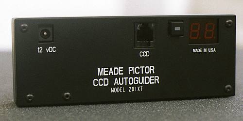

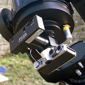

If you are referring to the camera as the guide switch, its overrides the scopes tracking / periodic error correction (PEC) Also I have 2 pics attached of a basic guide camera/installed. I cant find a schematic of these but I read that the sensor chip tells 4 relays to close contacts/ with maybe some voltage to the modular connector that plugs in the panel port.

I am still confused because a 'port' is a multi-terminal connection, and the red diagram is a complete circuit with two ports. Am I right in assuming that the red diagram is a discrete circuit that plugs into the CCD port on the Meade Pictor Autoguider? And the joystick connects to the 5 pin ll Port on the LH side?
The 'guide switch' I referred to is the switch shown at the centre of the red diagram and marked 'on/off guide switch (guiding is on)'.
It would help if we knew what is on the other side of the CCD port, ie. do the 4066 outputs have to go high or low to turn on the relays?

The red diagram is all the electronics in the panel, note the 6 pins on right, they are the pins (RJ12) on the front of the panel.
