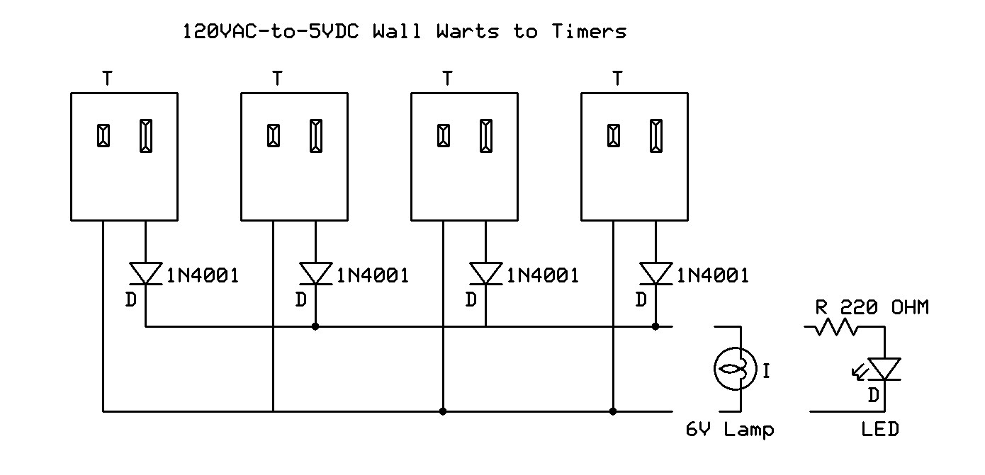

Just an off the wall (wart) solution. Each timer is connected to the input of cheap (or free), used 5V cellphone chargers (wall warts). They're available from thrift stores...or you friends for free. They're 5VDC outputs are diode-logic OR'ed to either an incandescent lamp or a resistor and LED. When any, or all, of the timers put out 120VAC the lamp lights. Will this work for you?

This may very well work! Thanks for the idea! The timers I'm evaluating are the CCTs from Automation Direct:
