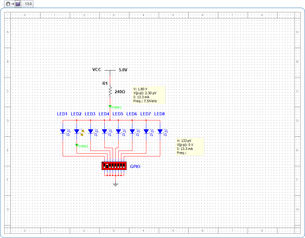

I am currently designing [b]an LED array[/b]. It consists of 20 LEDs which will light up one at a time in sequence. The first design looked something like this with the switch array representing logic 0 outputs on micro-controller:
Buffer Resistor Design
IR On.png (151.7 KiB) Viewed 13265 times

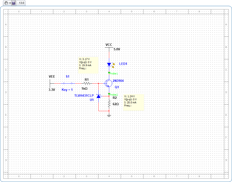

I need to ensure that the intensities are controlled however using a constant current method. I have decided upon this design which uses a shunt regulator to maintain required current through LED:
Shunt Regulator Design
TLV431 Single IR LED ON.png (81.85 KiB) Viewed 13265 times
The problem I am having is that I cannot come up with a suitable way of replicating this design x20 times over, short of just using x20 of each components. Any ideas? MUX's are expensive no?

Postby pebe » Sat Jul 26, 2014 7:18 am
Why do you need a constant current controller?
I assume you are using a stab 5V source, in which case your simple resistor feed, R1, should be OK.

Postby Veys » Sat Jul 26, 2014 11:24 pm
LED intensities depend on current flow through them. The application requires the LEDs to operate at known wavelengths and so the typical buffer resistor design is not adequate.

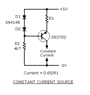

Postby pebe » Sun Jul 27, 2014 8:54 am
The wavelength of a LED is determined during manufacture and stays the same whatever current is used to drive it. I have driven an IR LEDs with pulses of 4us at a current at over 1A to get a range of 30ft, and the wavelength did not change. I would be interested to know your application.
If your application is very fussy on drive current I can give you a simple constant current circuit to replace R1 in your first circuit.
Re: Current Driven LED Circuit
Postby Veys » Sun Jul 27, 2014 9:23 am
It is the intensity that varies not the wavelength. I ensure uniform
brightness is controlled via current input.
Postby pebe » Sun Jul 27, 2014 9:45 am
[quote="Veys"]The application requires the LEDs to operate at known wavelengths and so the typical buffer resistor design is not adequate.[/quote]
I assumed that you thought the wavelength changed.
[quote]I ensure uniform brightness is controlled via current input.[/quote]
In your top circuit, R1 is common to all LEDs, so they should be equally bright.
Postby Veys » Sun Jul 27, 2014 10:09 am
Apologies the wording was ambiguous. The purpose is to emit pre-defined wavelengths at equal intensities. Thus if the current isn't controlled I will have no control over the intensity emited. Any circuit revisions are welcome. :)
Postby pebe » Sun Jul 27, 2014 11:15 am
This constant current circuit can replace R1 in your top circuit.
Constant Current 2.GIF (2.86 KiB) Viewed 13207 times
